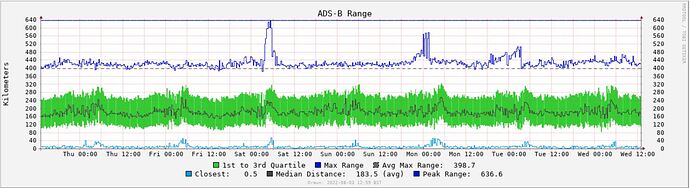

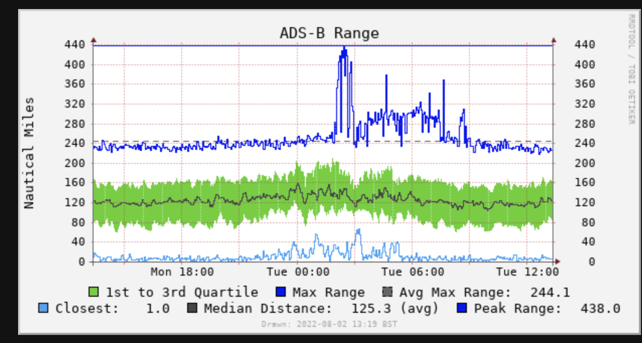

Today I have an unbelievable ADS-B peak range of 438. Was I the only one this morning?
It looks like it came from Poland.
IDK, with the war, might be spoofed/changed GSM signals? Testing?
Nothing special noted here at that time.
That spike might be a fluke.
Nah … that’s pretty likely to be ducting.
Check /?ptracks … click the tracks over poland / see how many there are.
Cross check with an aggregation site.

Being that contrary to the last graph this graph is in nautical miles … that’s a lot.
I got some movement
500-520 nautical miles? IMO that is unheard of…

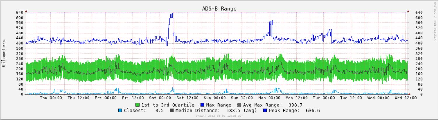

It’s not unheard of but it’s an impressive average. I’d love to see the one year or two year graphs @fishymamba
I only have one year on this current Pi. I’ve also made lots of setup changes along the way.
As you can see the ducting goes down significantly in the winter. The drop in range you see near the current date is due to a freak storm system that passed in the area.

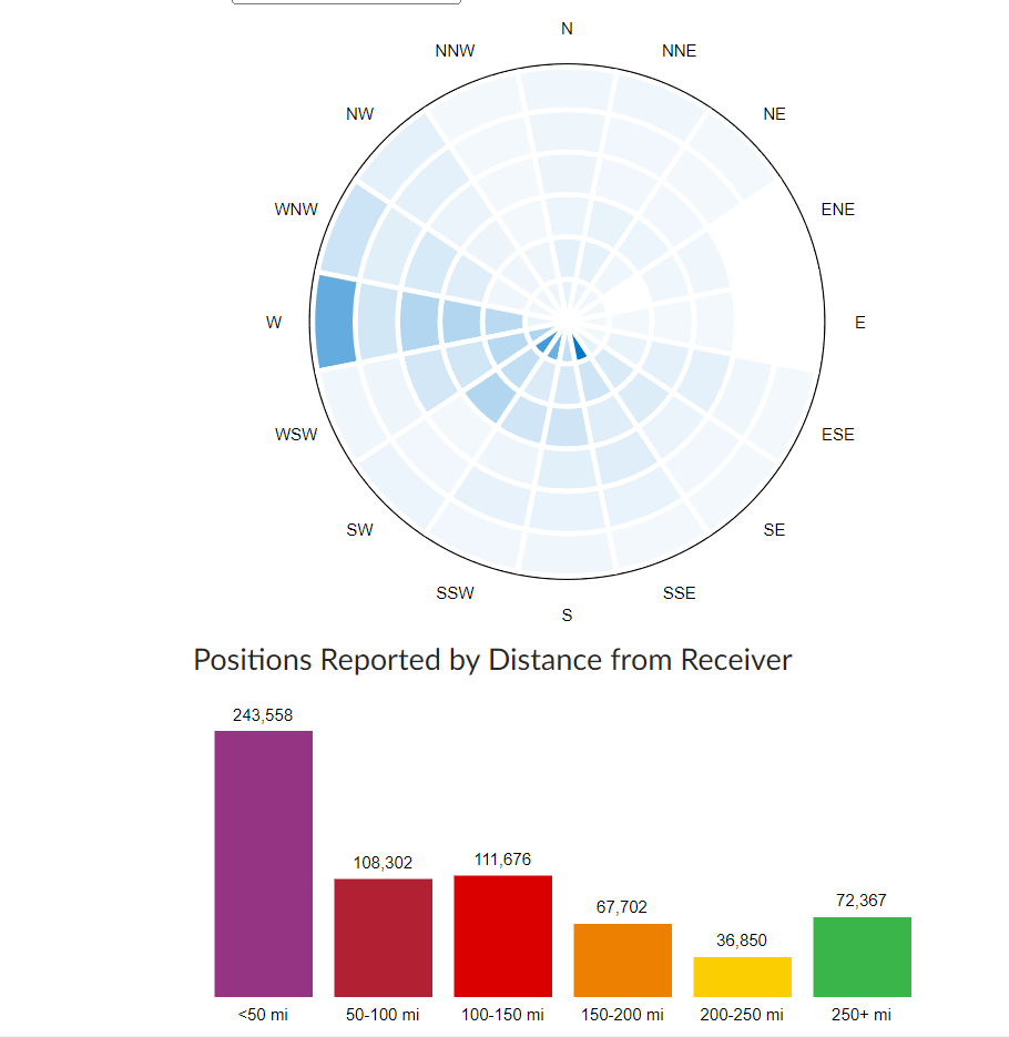

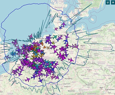

Really interested to know what your exact setup is.
It’s very good, it looks as though you have a lot of traffic off to the west. Any chance of a screen grab of your map when it’s got aircraft at range please, I’d love to see it.
520 nm? That’s 960 km! Or 600 miles. Consistently? I don’t know of anyone with this range, to me this is suspicious…
It’s like BOTH the plane and antenna are at 45,000 ft!
If antenna drops to about 4000 ft, the airplanes at 45,000 ft (and there are not many there) would be at about 600 km:
IMO he has two antennas combined in one feeder, see the big jump in positions “far away”?
