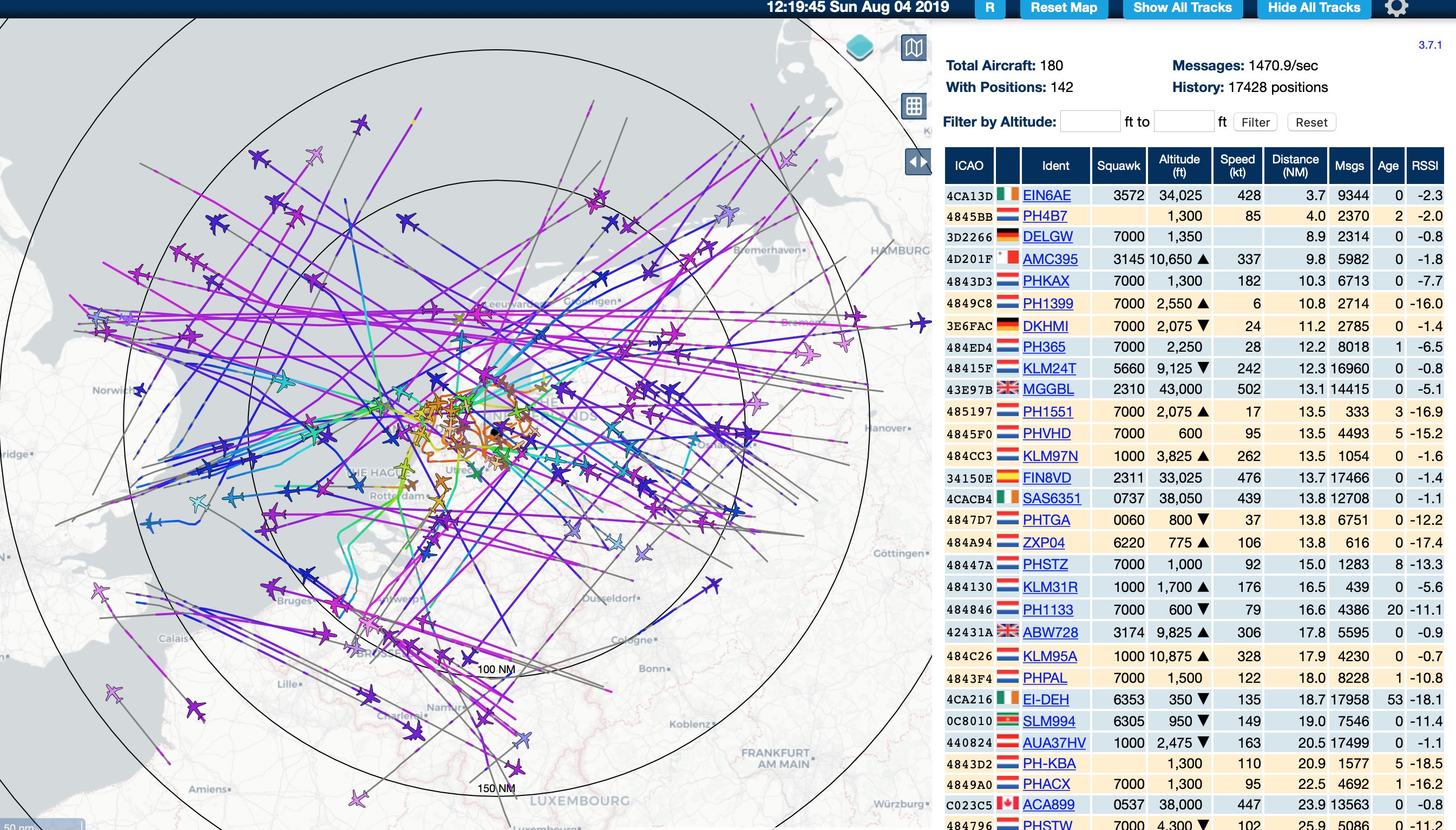

Due to my favourable location my feeder covers the airspace between London, Paris, Brussels, Amsterdam and Frankfurt so my orange FA dongle has to swallow quite some traffic. More than 250 planes in the air and 1300 msg/s is no exception so statistically I’m not doing too bad ranking just outside the top 100 flight feeders. I’ve been tampering with the RF gain to maximize the throughput but I always end up with either losing long range or overhead traffic, it seems that the 8 bit ADC of the RT820 is the limiting factor for the dynamic range I would like to obtain. I already have a better SDR, the RSP2 from SDRPlay but I believe it’s not really compatible with dump1090 so I prefer to use it for other purposes. Maybe I should give the Airspy R2 a try, I guess that it’ll need a preamp as well?
