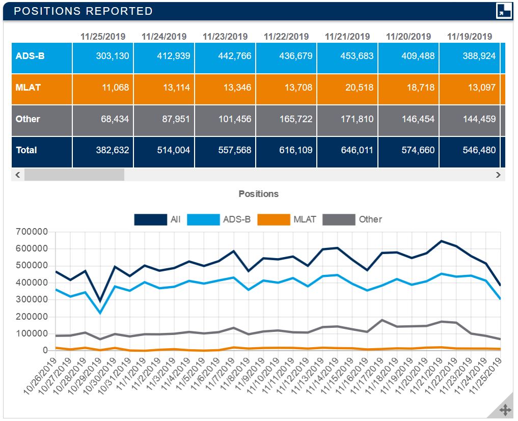

My site has been seeing a number of “other”
Aircraft. Several days ago I reduced the AirSpy RF gain 9 dB. Previously the system was “optimized” for max message rate. Now the gain is lowered to the point that few signals reach 0 dBFS. I tend to make one change and wait a few weeks or a month to see results. This last change is immediately visible in the “other” aircraft daily counts.
As the site’s daily count is around 5,000 a reduction from around 450 to 150 is significant.
Nov 25: I did a generation-hopping upgrade today. AirSpy code from v1.37 to v1.85. Gain reset to 21. Default options.
If you update to the most recent version of the airspy decoder, there is now some filtering which will largely eliminate spurious data, and allow you to put the gain back up to optimise message rate and range. Have a look on the airspy decoder thread if you haven’t seen it.
That’s definitely the case with Airspy. The software was polished a lot in the last couple of weeks.
Thanks. I’ll upgrade the Airspy code: I’m down several generations.

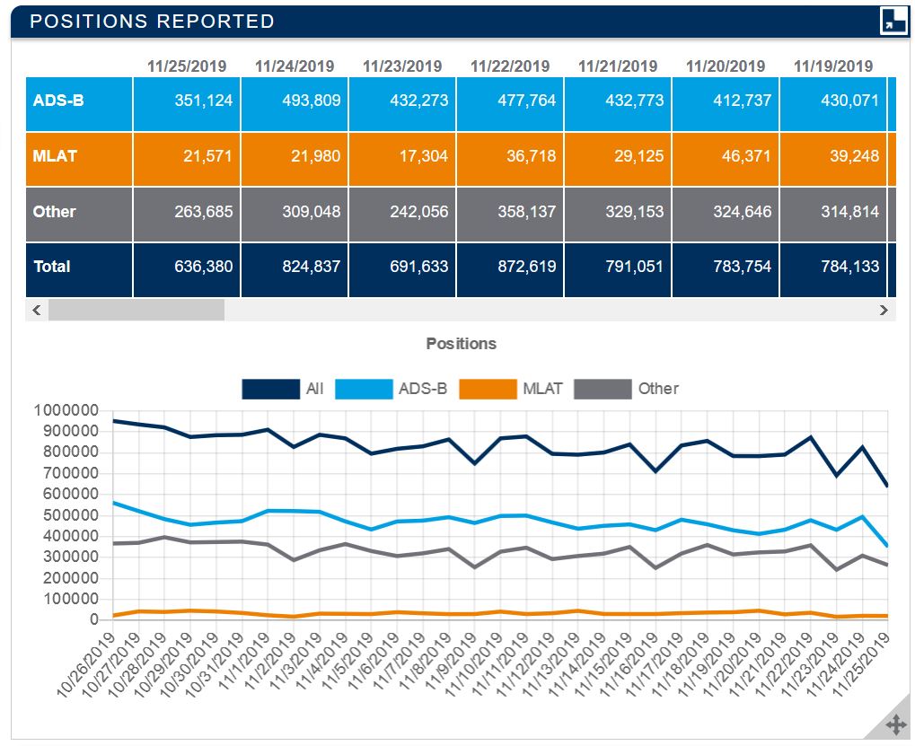

I haven’t looked at the UK leaderboard for quite a while and I’m stunned to see that there’s a new top station with over 1,500 ‘other’ aircraft/day. Even being in the busiest location, I struggle to see how anyone can realistically see that number of ‘other’ aircraft.

That guy seems to not have updated his decoder with the current one (from the numbers I’m guessing he’s using an airspy), and is probably using the -x switch, which produces a lot of bogus data. Almost all of the “other” aircraft seen by him will be false. Have a look at the graph for me, suffolk3000 or andy b, and you can see really clearly where we started using the new decoder. A hit in the stats, but at least the data is real.
Until FA update their filtering there’s not much to be done about it.

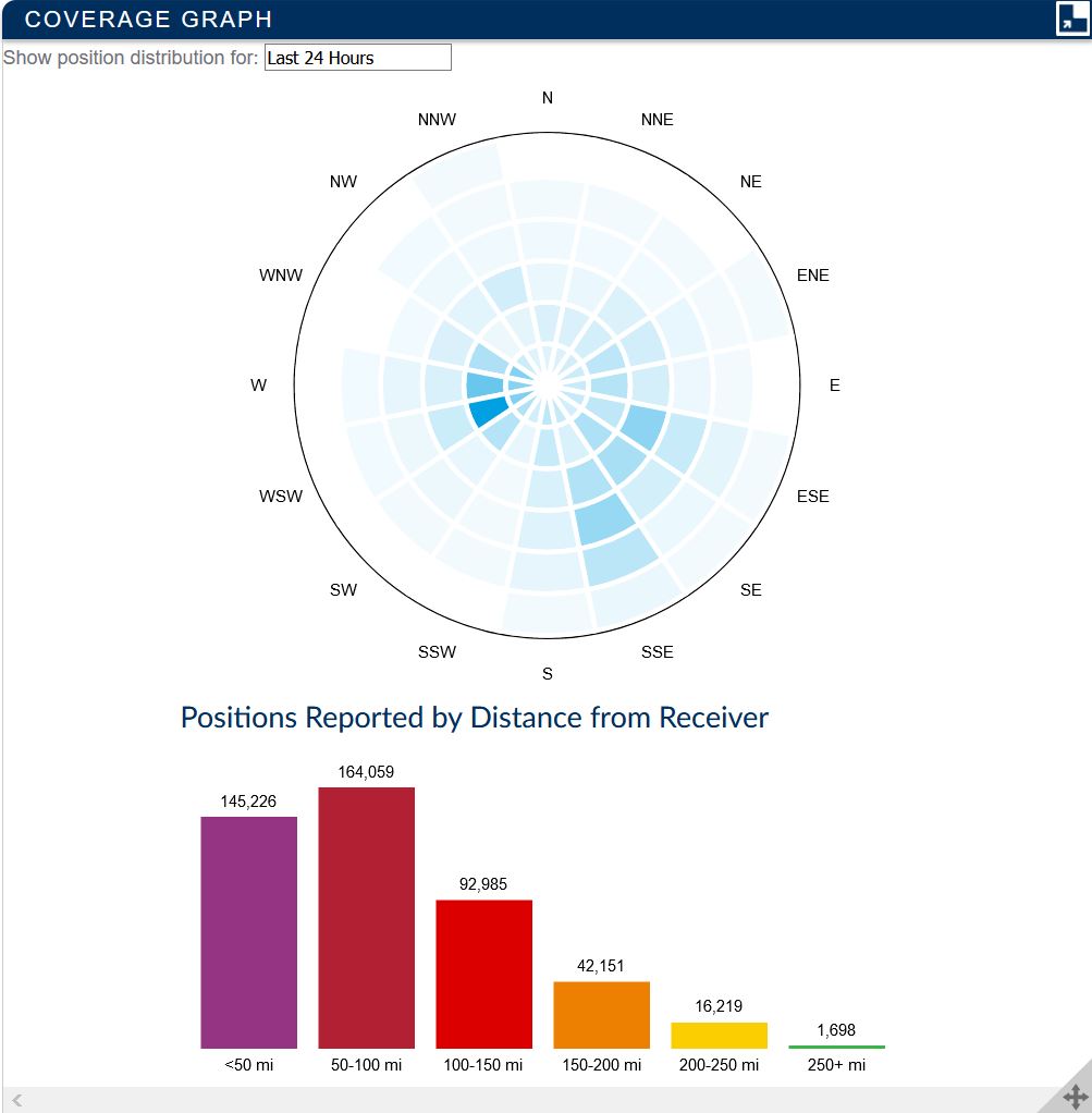

@keithma numbers are big close-by, the far-away ones help of course, but they are not the main reason for the positions - 67% of his positions are in <100 mile range, 95.5% are in the <150 mile range:
Also, it “helps” that his “Other positions” is unusual high. I won’t comment, I already said something about FA taking those in calculation…
LE: My “Other positions” numbers are very small with the -w 3 option.
