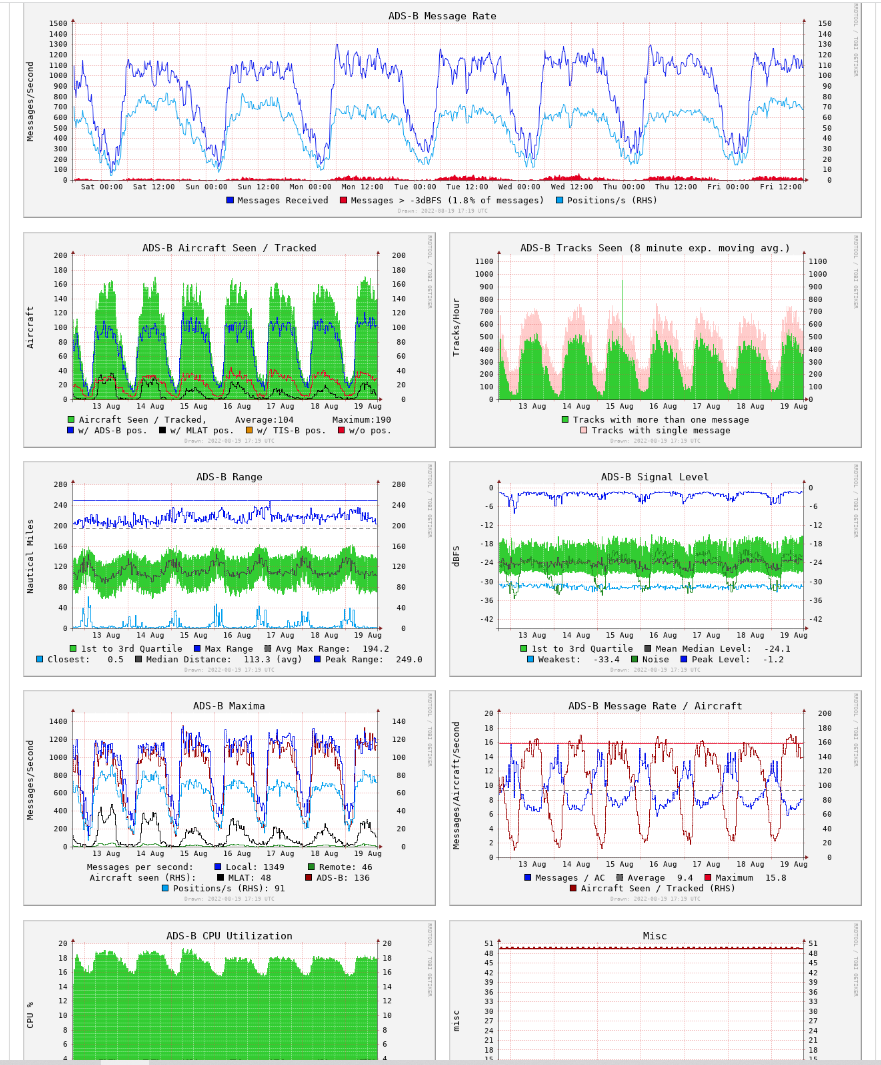

I was wondering of somebody can see on the graphs from mine receiver what i can do to make it better.

Looking at your range and message count you are already doing quite nicely with this setup.
Also the number of messages stronger then 3dbFS is stayin well below the aiming point of 5%. You have not a lot of aircraft with just one message so it seems you are set up quite nicely.
Setting the gain manually,it depends if you have the package installation or working with the SD card image installation
Automatic gain can be usefull but that might be to high to your liking.
Set the gain manually and wait 24 hrs to see if there is an improvement or a decline in your reception.
Don’t expect wonders, autogain checks once per hour to see if the value is still correct but it seems to be quite steady in your set-up.
Don’t you see any aircraft with the filter added ? It seems it filters out some noise in your graphs but the noise figure is already low

Your values are looking good. I would simply leave it as it is and enjoy feeding. Sometimes you got yourself lost in all these settings.

Because both of you say that the graphs look good, i do not change anything for a while.

Depending on your equipment it doesn’t matter what you’re using.
Look at the values posted by tomvdhorst.
Simply pick and choose and let the value run for at least 24 hours.
I think you will not get any significant better.
