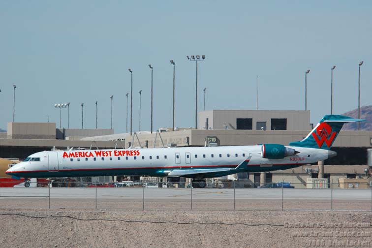

Even worse is the CRJ-900. The engines look so small and the fuselage looks so loooong.
