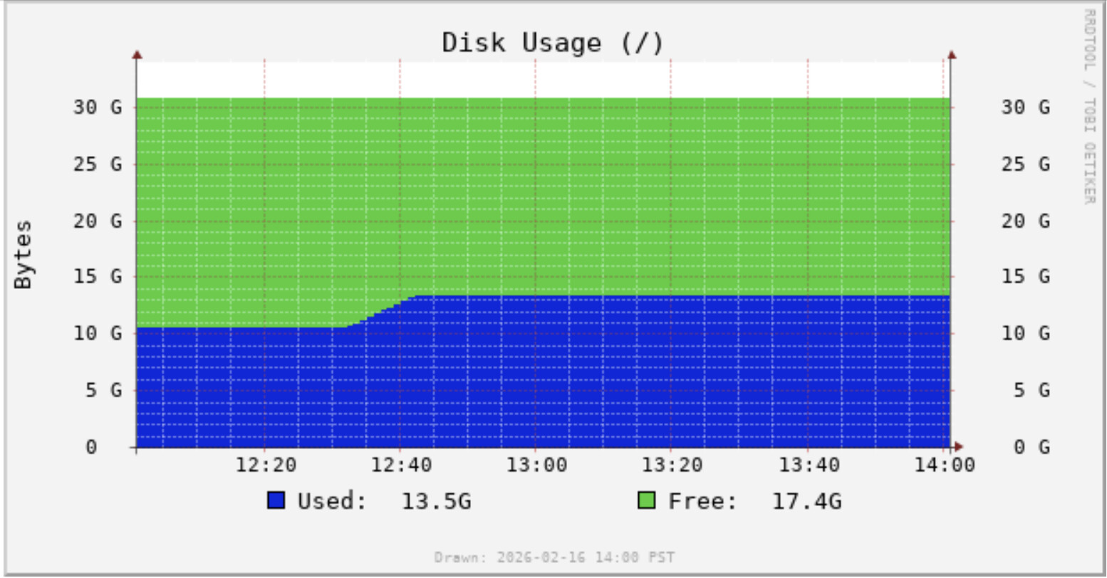

2.8 GBytes file. So now I do see that on graphs1090.

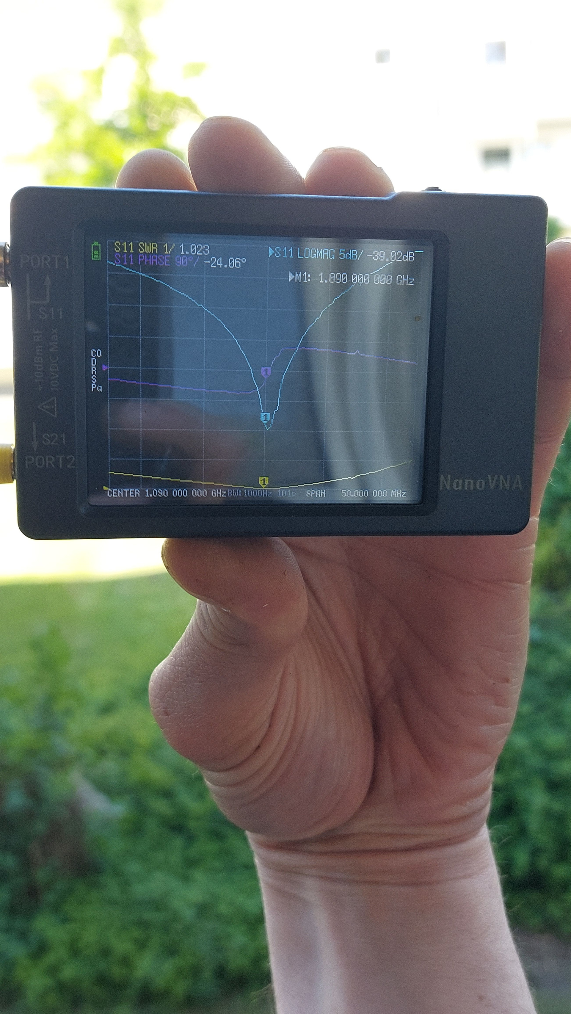

So i grabbed a few recordings. They are not very representative. Some classic yagi. Some loop-quad-some-shape-inbetween-let’s say round rectangle yagi. I am running this now through the optimizer. I had some previous run. And it was good.
However, i changed now the optimizer to be a bit more fine grained about how to guess a good filter. Before it was 5 gain points, now it is 9.
Edit: Let me explain the problem. I cannot record crazy sample set right now. I am neither on vacation on the sea. Nor does the weather permit some fancy place to setup. On top of this comes that the shitty looking lunchbox
is a beast and does not reflect in any way the average antenna. By design it is very narrow bandwidth it has some stupid gain (the loop as driven element offers more than a dipole). It has been optimized by the computer to fit in the box and fine tuned with a VNA for the refraction in the plastic. I will record hopefully some more samples in the next days.
Edit2: Yes, the front element is too low. It has been measured and lifted.
I used the above antenna now for a new seed for the filters. Once something has been found, i continued with a larger standard yagi sample to find something better. That is now the default in the repo.
Let me know if that works for you.
