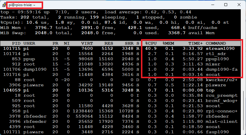

On RPi Model 4 with 4 GB ram
NOTE:
I don’t have readsb installed, but have dump1090-fa installed. I used it.
In file /etc/default/dump1090-fa:
(1) changed RECEIVER=rtlsdr to RECEIVER=none, to run it in net-only mode.
(2) Set NET_RAW_INPUT_PORTS= to NET_RAW_INPUT_PORTS=30001
Click on Screenshot to See Larger Size
Seems you are running it via rtl_sdr, very nice. And i am happy that this actually works with that cpu load on a rb 4. I had concerns because of the exeessive use of 64 bit in the code.

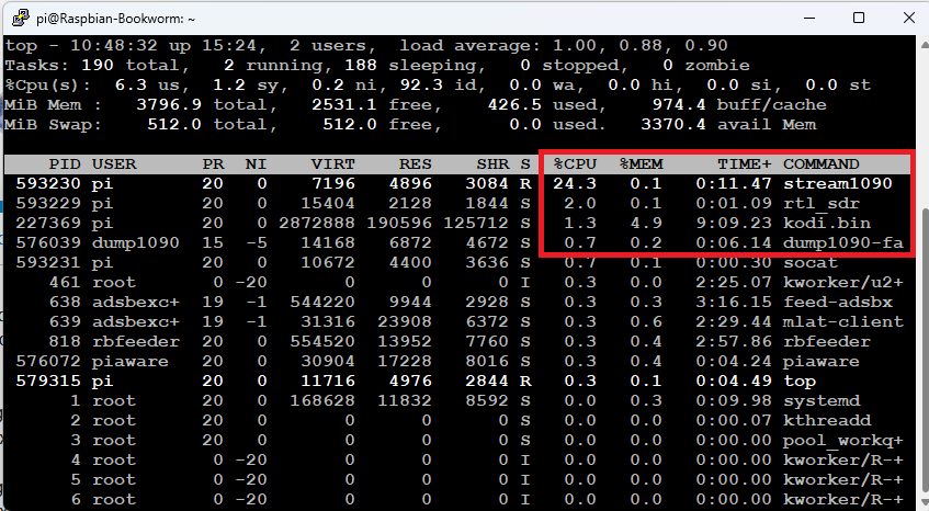

Yes, you are right. Please see the screenshot below which shows the command I used to run it.
It works fine with airspy mini:
This is with stream1090 -a flag.
airspy_rx command line is airspy_rx -a 6000000 -f 1090 -g 15 -r -
CPU usage on a pi 4 is:
CPU usage with the -b flag is:

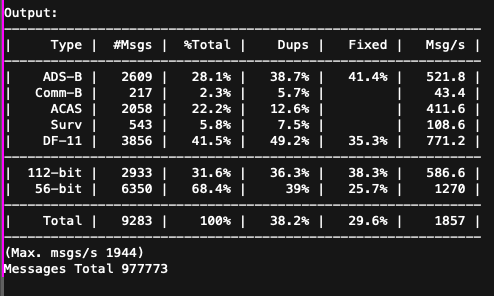

and the message summary:
Which is very good.

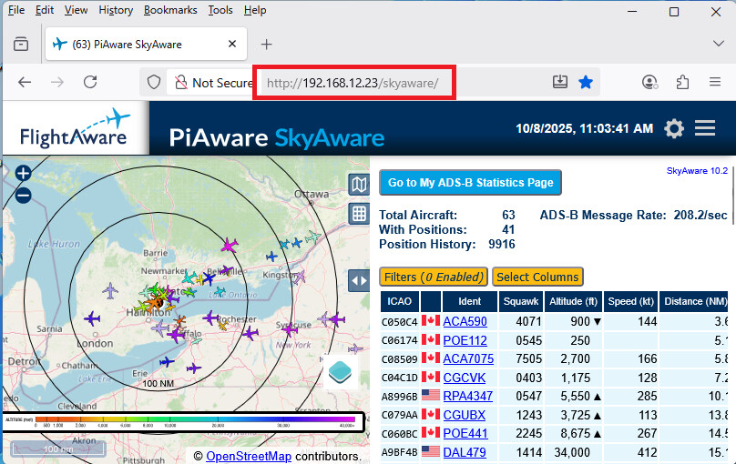

OK, installed stream1090 on another RPi Model 4 which has a better antenna, at a better location (but still indoord, as I cannot install outdoor antennas), and Flightaware ProStick Plus (blue) with FA 1090 Filter.
With -g 49.6
With -g 0
CPU & Memory usage is more or less same in both cases:
Skyaware Map
dump1090-fa running with:
--net-only
--net-ri-port 30001
dump1090-fa’s status showing settings as underlined in red
Click on Screenshot to See larger Size

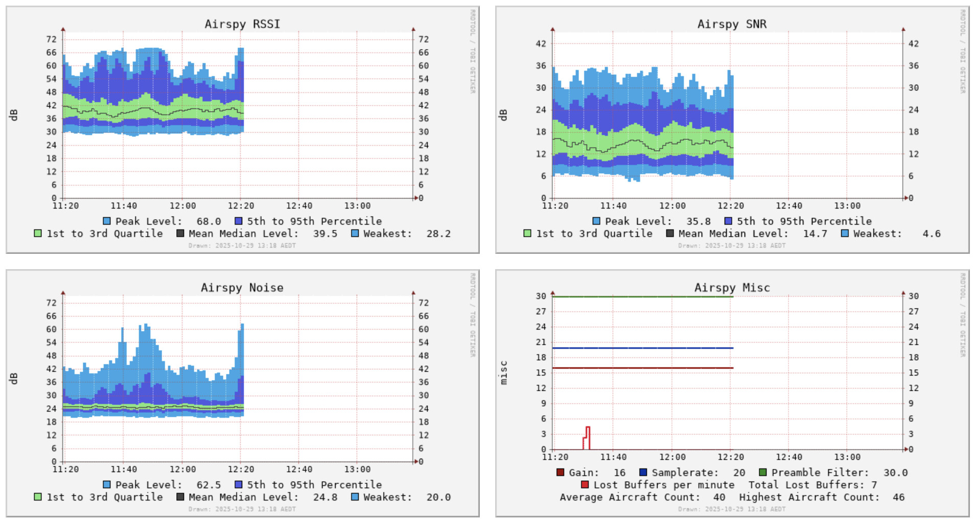

The following charts show a two hour window swapping from airspy_adsb to stream1090 at 12:22 local time.
These are the airspy graphs to give you an idea of signal quality.

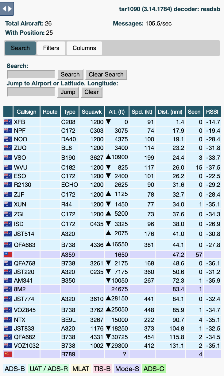

The following grabs from tar1090 are one minute apart - stream1090
Back to airspy_adsb
The number of aircraft is similar.
I tried to make the parameters for the test as close as possible.
