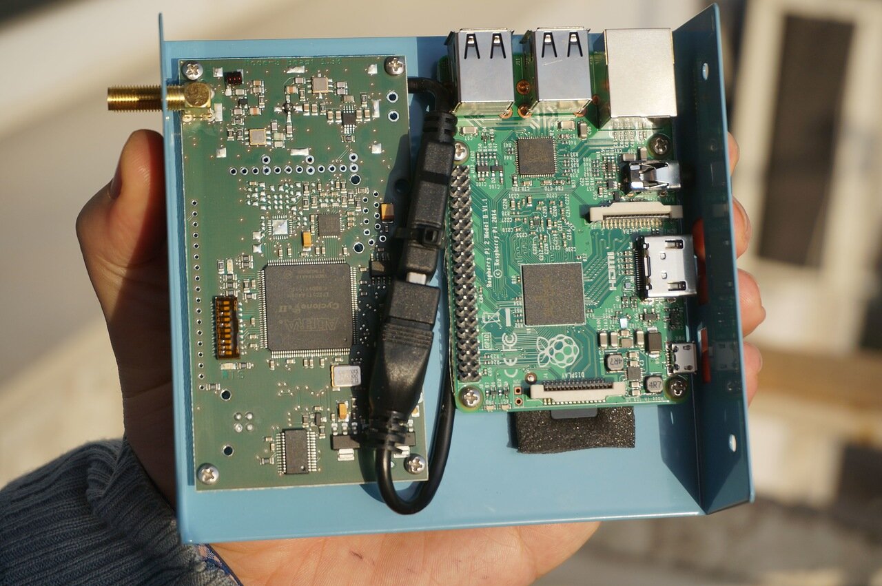

Look at the picture, it is a Pi and a beast receiver : )
Edit: it is a old FA Flightfeeder with a Beast receiver, I think
The author demonstrates the configuration of his receiver with the cover removed. But with cables connected.

Well, I have never seen a Beast, open or fully enclosed, neither in real nor in photo, so cannot make out.
Why the OP assumes that by looking at photo, people will know what it is. Why not explicitly say “I am using a Beast Recriver”
Because the author does not know about his receiver:
By the way, it was Flightaware Feeder

You mean to say it is Flightaware feeder, the older model which used Beast receiver. FA current models use RPi+ProStick receivers.

FlightFeeder version 6 looks like this inside:
so I think it’s a version 7:
FF
If author use the piAware image, then everything will work right away. It remains only to install and configure ModeSMixer2 and install FR24, PF, RB, PP (FA already installed).
For the ADSBX image I had to compile. Therefore, I recommend using piAware.
