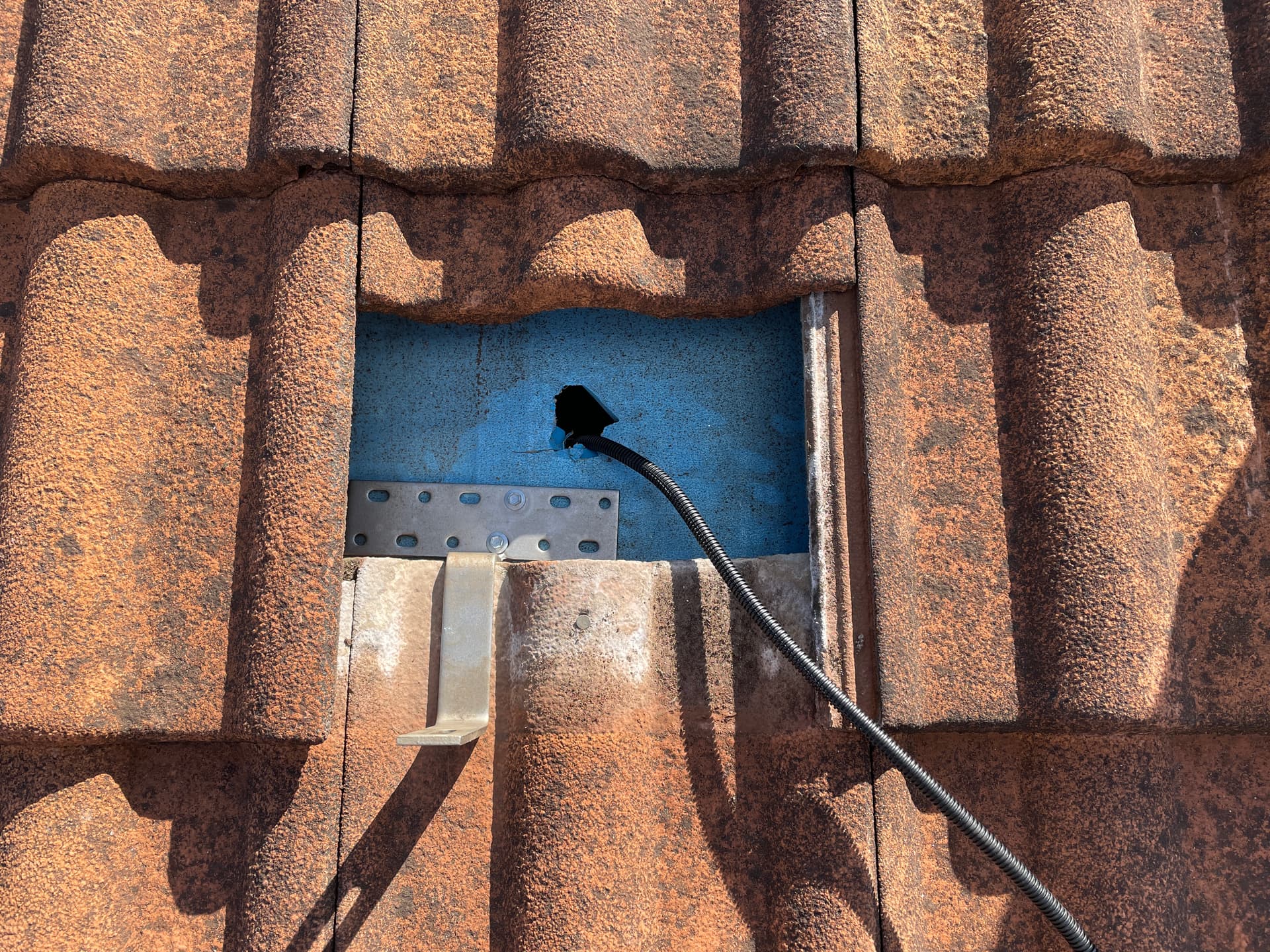

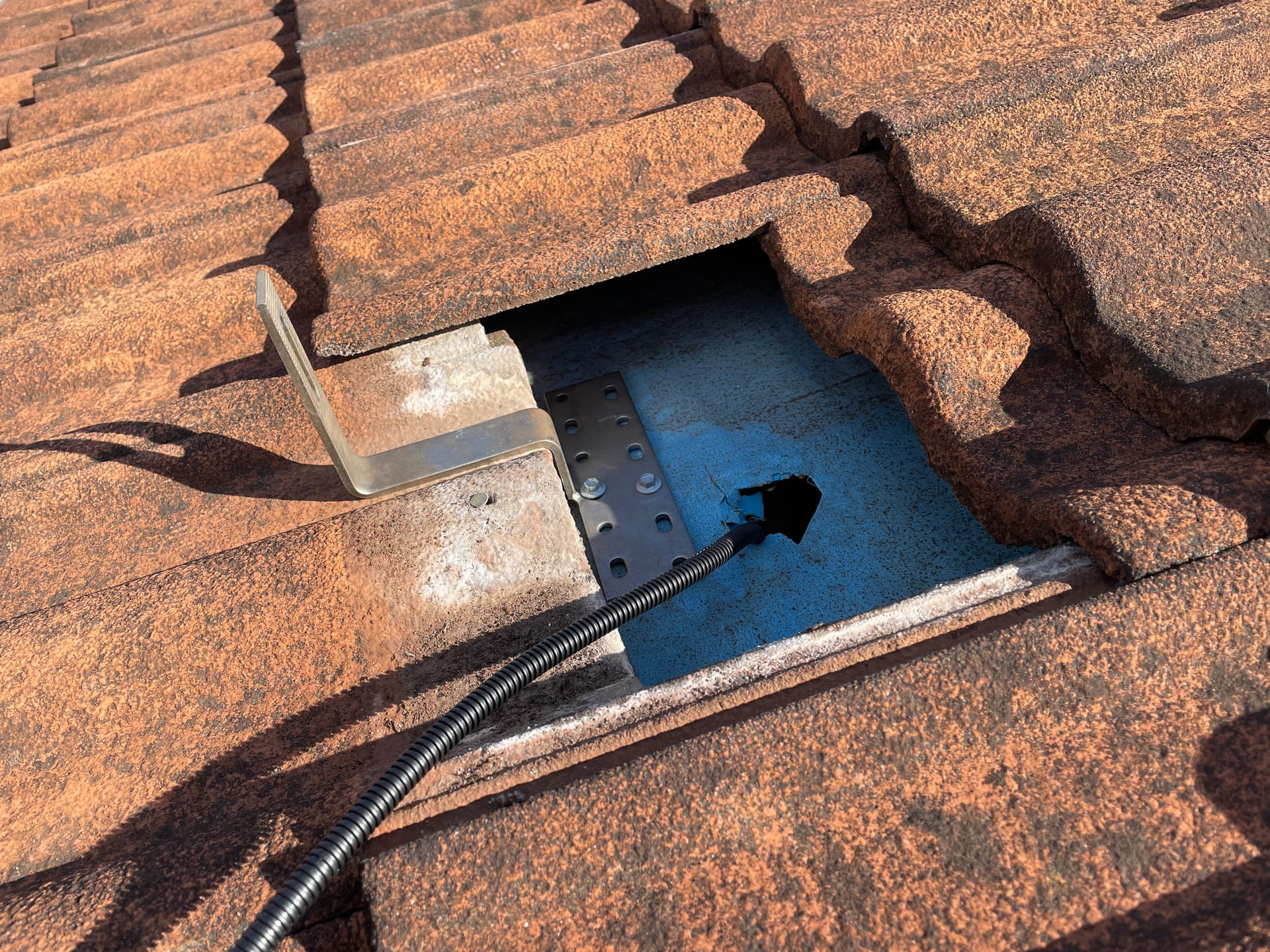

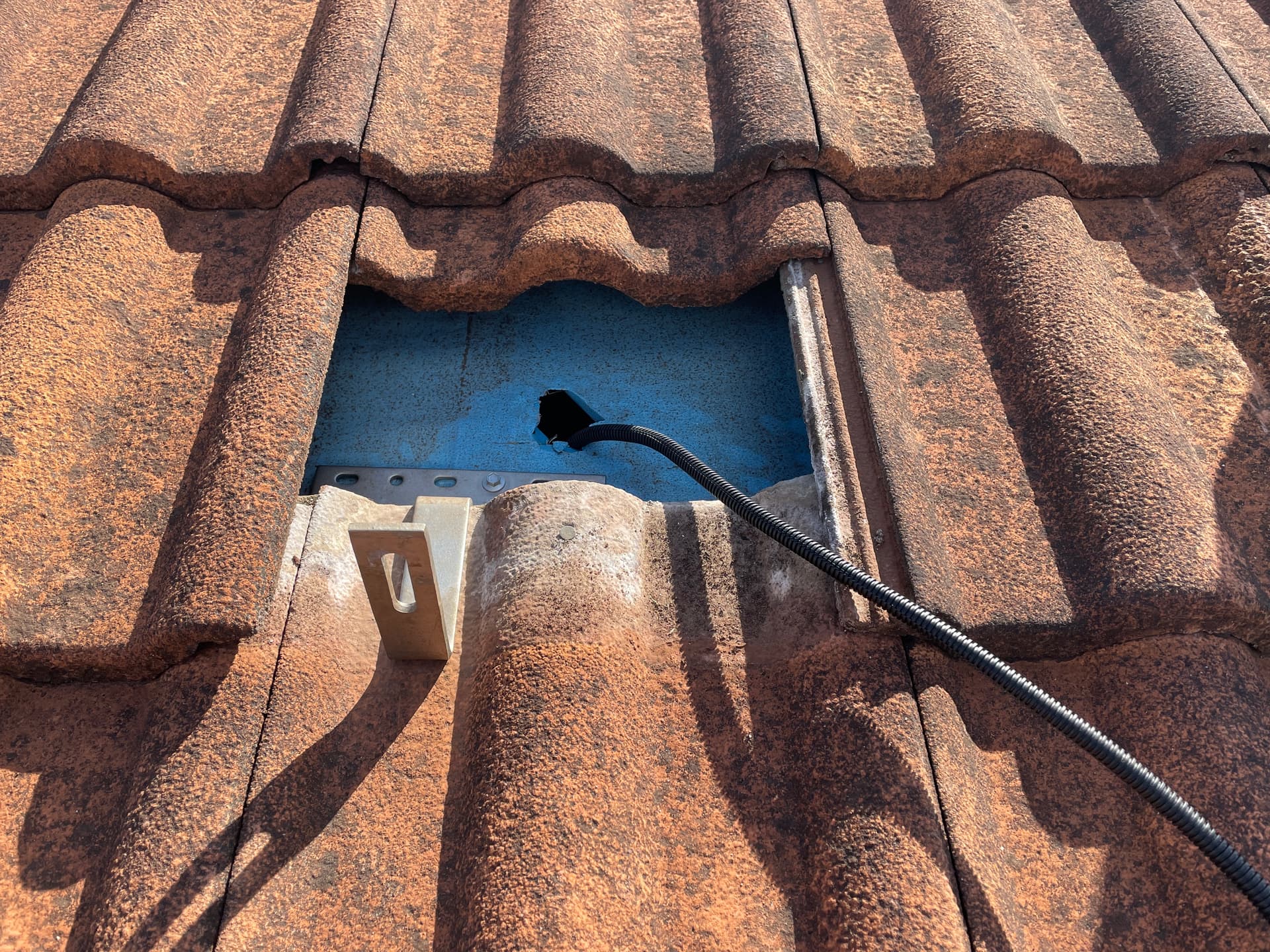

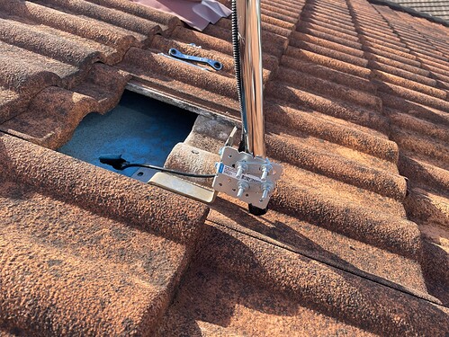

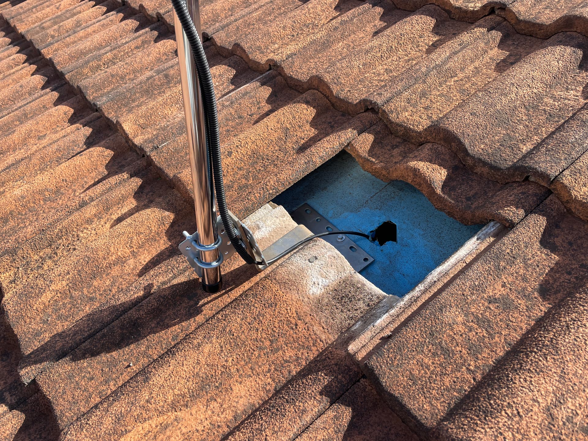

Just thought I’d share my solution for roof mounting my antenna. Might help someone else in my position.
I though my options were either an eaves mount or try to use my tv antenna mast. Both of these meant I’d run into cable length or pi positioning issues which were not optimal.
I ended up thinking about solar panel mounting feet and got two (second hand) for free off a local solar installer.
