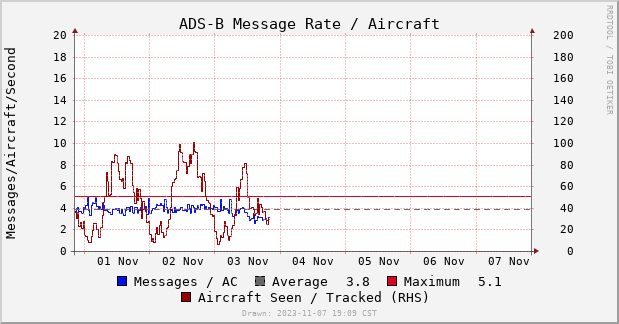

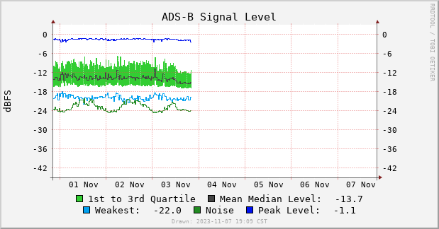

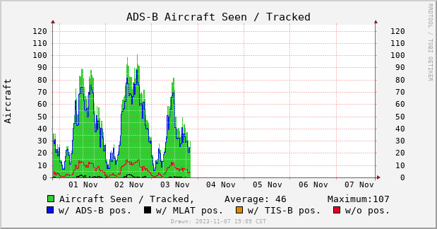

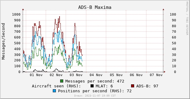

Apparently graphs1090 just… stopped… collecting data on Friday evening. Not sure what’s going on there, but here’s what I have. I’ve tried to restart graphs1090 but nothing, so I’ll reinstall it and hope it works.
You’ll note the sudden and drop around 12:00 on Friday.
Based on the partial information I see two things:
  • Your weakest signals are quite high ( -22,8 dB)
  • your noise figure is at 11,1%
Most likely you are too high on the gain but that should be visible when you have a longer duration of the graphs.
