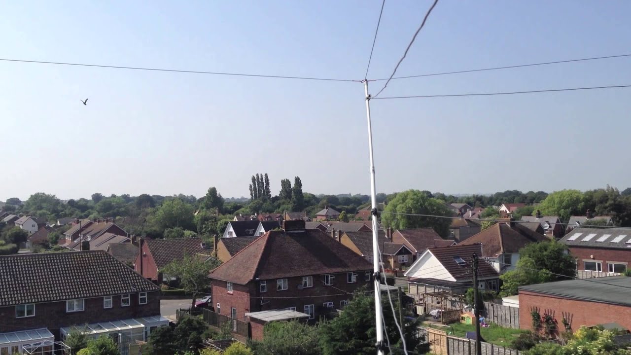

That’s pretty significant for a seemingly small change in antenna position. Maybe it’s just lifting it clear of some obstruction. Perhaps if you ran the heatmap script in both positions you could see where the gain is coming from.
Look at the first picture, the stub mast is blocking it.
What about the house in the background or in another direction, any of them able to block reception?
Anyhow, the flatter the area the more increasing height is gonna give you in return i think.
I’m surprised that the stub mast is having such a big effect, but then I suppose it is quite close to the antenna. Assuming that’s the sole cause, perhaps offsetting the antenna horizontally would help - it would reduce the angular size of the mast from the viewpoint of the antenna

Nope, the aerial in the previous position had a clear view in all directions, except where it was blocked by the stub. Bear in mind that a 2" steel pole that close to the aerial is going to be quite a good block for weak signals in that direction. What it might be worth me doing if I have to move it back is look at the signal strength heatmap and use that to decide which corner of the main mast I fix it to.
That’s a possibility as well - The further away I get it, the smaller the effect will be. That does mean getting some complicated mounting system though which may be tricky. I’d much rather see if I can somehow keep it high. I’m thinking perhaps separate the aerial from the feeder box as that will make it easier to get higher. Of course, then I’ll have a run of cable back into the box which I don’t have now.
if you look on the first picture, you can see I have exactly that! It’s an inverted L aerial, the feed point is at the bottom of the mast with a smartuner, the aerial goes up through the insulator you can see leaning away from the mast and then off to a 20’ pole at the end of the garden. I use it for top band through to 30m.
There are trees, houses further away from you that block the lower angles to horizon.
Higher you go, lower those angles become, more planes you can pick from far away - if there are any that far.
As for the pole being a blockage - planes will “fly” past that shadow, and still be counted. You’ll lose just a few positions, unless the plane flies directly towards the antenna from that direction.
To me, raising the antenna did the same thing - propelled me on the “top” of my 25 mile radius list.
I made a video a few years ago… This is from about 2ft higher than the feeder was situated and is about 5ft lower than it is now. It goes all the way from north to north in a clockwise direction and then back anti clockwise, pausing at 270, 180 and 90 degrees. The huge tree to the east isn’t there any more.
As you can see, I do have a good view :slight_smile:
