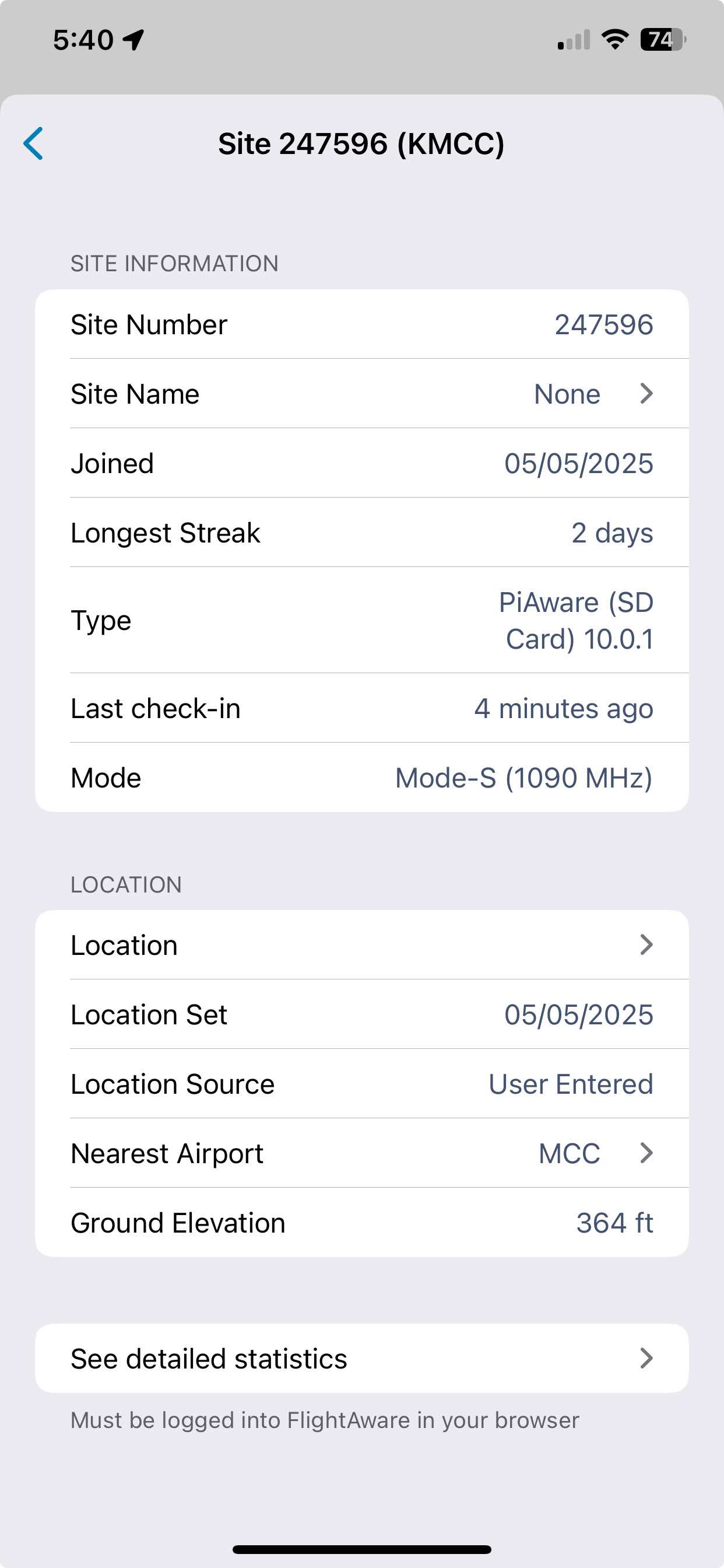

It seems like it took longer than usual for the Pro’s LCD screen to show the pi’s boot process after restarting. So, be patient after powering it up! I missed the fact that there’s a different PiAware image with LCD support the first time I downloaded the image.
I also found it interesting that the FlightAware app now knows about the Pro, without my needing to do the ā€œset up a new ADS-B receiverā€ step.
If this works for you as well then you should now be able to tap on the receiver in the ā€œMy receiversā€ list and then configure/fine tune the lat, lon, and altitude. Giving it the correct lat/lon/altitude is crucial for MLAT support. To do this, tap on your receiver, then tap on the ā€˜location’ item. Although there doesn’t appear to be a way to manually enter/type the lat/lon of the receiver, I was able to pan/zoom the map around and successfully placed the little blue receiver icon right on top of my house.
Let me know if you have the same success.

Good news mine is working now. I had to re-do the flash for some reason but now it is working and linked to my account.
