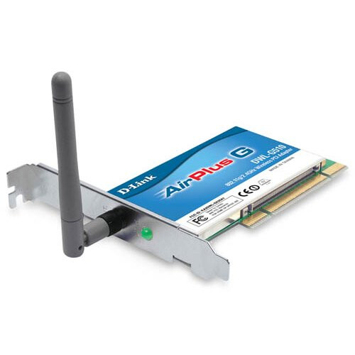

I mention this because, about 15 years ago, we used wireless internet. Initially, providers used radios connected via coaxial cables—sometimes 10 meters or more of RG213 or even RG58—to 2.4 GHz omnidirectional antennas; at the customer’s home, a grid antenna with a coaxial cable and a PCI card was used to pick up the signal. Ubiquiti’s brilliant move was to eliminate coaxial cables and make the equipment outdoor-ready: this facilitates and simplifies installation while also reducing signal loss.
