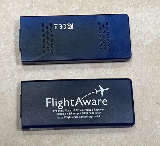

Setup is: Indoor Antenna > PiAware Pro Stick Plus > RPi4 > wifi
Setup is sitting in a west facing window, and heat does seem to be an issue with the Pro Stick Plus.
Pro Stick Plus was purchased in Mar '19.
Defective Pro Stick Plus?

Did you try a different USB port to determine if it is the Prostick or a wonky USB port ?
I originally had USB connectivity issues when I first tried to use the 3.0 blue USB ports on the Rpi 4. Moved the Pro stick plus to the white USB port and all has been up and steady for a long time.
A drop on Sun Apr. 20 for 29 hours, then it worked for 27 hours starting Mon, and dropped again on Tues at 11AM. I’m using the USB2.0 port. I just swapped in a USB extension cable. After this the only thing left is the FlightAware Pro Stick and the antenna, since I’ve swapped out everything else: PSU, microSD card, RPi, and today a USB extension cable.
