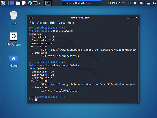

Debian 11 amd64
Kali Linux 2021 amd64
Successfully upgraded to ver 7.0 by installing pre-built packages of piaware, dump1090-fa, dump978-fa, and piaware-web.
Simple. Used command “sudo apt install [package-name]”. Please see following How-To:
Kali 2021 amd64 - Package install of ver 7.0 piaware, dump1090-fa, piaware-web, dump978-fa
