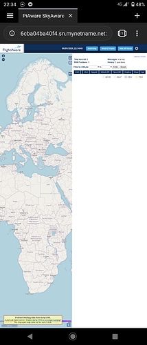

On Friday I went to my village and later that night I received another outage email. I called a neighbor next day at noon and he did a restart on the feeder. I started sending data, but stopped after 8 hours.
Today I came back, and I did put back the original power supply, restarted the feeder and everything was fine. It is sending data so far, but I am not sure for how long.
I am just out of options.
