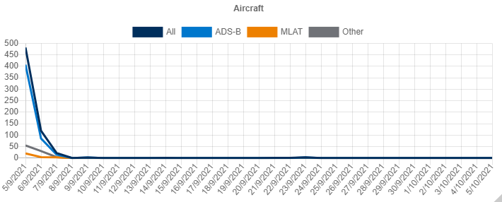

The system itself seems to be running just fine, dump1090 is running, mlat-client is running, everything is connected back to FA, it’s just not seeing any positions. Quick snippet from the logs:
Oct 5 07:45:24 piaware piaware[1783]: mlat-client(1802): Receiver status: connected
Oct 5 07:45:24 piaware piaware[1783]: mlat-client(1802): Server status: not synchronized with any nearby receivers
Oct 5 07:45:24 piaware piaware[1783]: mlat-client(1802): Receiver: 0.0 msg/s received 0.0 msg/s processed (0%)
Oct 5 07:45:24 piaware piaware[1783]: mlat-client(1802): Server: 0.0 kB/s from server 0.0kB/s TCP to server 0.0kB/s UDP to server
Oct 5 07:45:24 piaware piaware[1783]: mlat-client(1802): Aircraft: 0 of 0 Mode S, 0 of 0 ADS-B used
Oct 5 07:45:42 piaware piaware[1783]: 0 msgs recv'd from dump1090-fa (0 in last 5m); 0 msgs sent to FlightAware
Oct 5 07:50:42 piaware piaware[1783]: 0 msgs recv'd from dump1090-fa (0 in last 5m); 0 msgs sent to FlightAware
Oct 5 07:55:12 piaware piaware[1783]: no new messages received in 3890 seconds, it might just be that there haven't been any aircraft nearby but I'm going to try to restart everything, just in case...
Oct 5 07:55:12 piaware piaware[1783]: faup1090 exited with SIG SIGHUP

I spent some time yesterday tweaking some of the piaware-config settings to switch off adaptive dynamic range, set “slow -cpu” to “no”, also set rtlsdr-gain to “max”.
Any other things I should be looking at that might help here? It was running PiAware 5 as the SDcard image and upgraded with “apt dist-upgrade” first to 6.0 then to 6.1 when it was released.

Your site is currently reporting 100% CPU use, so that may have been a bad idea (though a vanilla piaware sdcard image with no changes & adaptive gain off should not take that much…). Maybe take a look at top to see whether it’s dump1090-fa taking all the CPU or if you have some other runaway process there.
Agreed, possibly not the best idea but I turned it off yesterday to see if that was causing the issue.
100% CPU must be an occasional occurrence. not sure where the stats page is pulling that from, monitoring top for a while shows dump1090-fa sitting around 40% CPU, give or take 5% or so.
