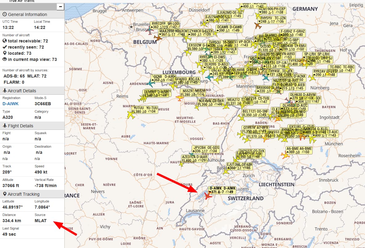

From my knowledge MLAT is showing you aircraft which are either out of range for your device or where the MLAT quality is higher than the ADS-B signal of your device.
I am using a Jetvision AirSquitter which is MLAT connected to the Jetvision network.
This is my current map of the device. The arrow points to an aircraft which is close to the max range of the ADS-B signal of my receiver, so it is shown via MLAT as the source is more reliable fo this aircraft.
In this example you see that there are seven additional aircraft (difference between 65 and 72) which are shown via MLAT only.
From time to time i am getting also the pushback of an aircraft from Flightaware
That’s just bogus, same for jetvision and FA where you receive positions for a certain time after contributing to any position of that aircraft.
So … yeah it’s disconnected from what you’re receiving.
