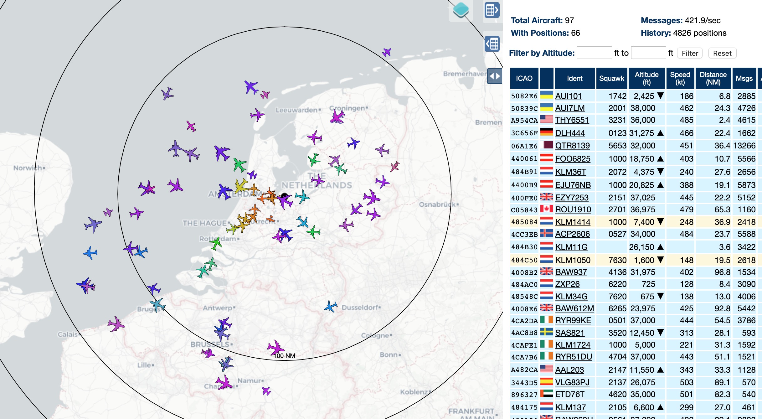

Replaced Flightaware antenna with Active Diapason Clone

@bramjacobse Did you noticed a huge difference? Your post doesn’t show a before and after. How did you mount the clone into your mast? You’re a few miles north of me :wink:
