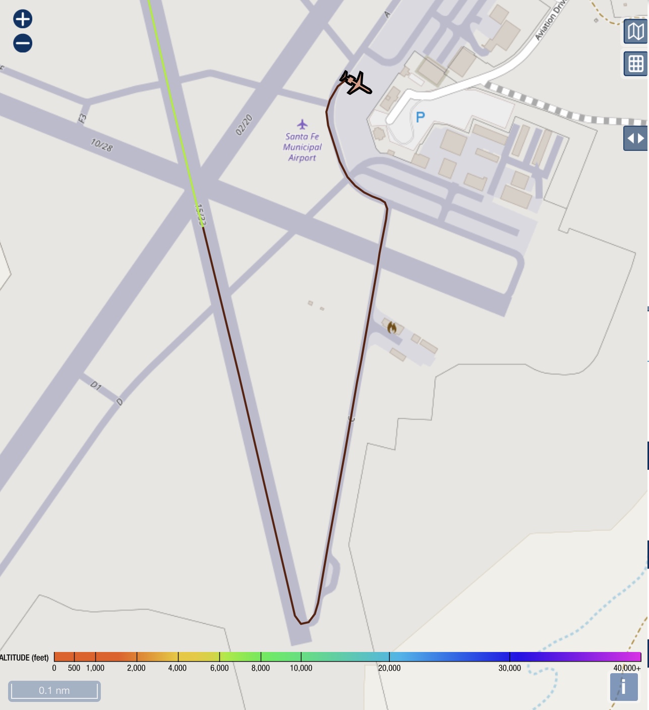

The PiAware software gives real-time plotting of aircraft locations, headings, and tracks on the map display with the positions being updated about every second unless there are drops. What you see is basically an animation of what’s happening as it happens. I see when aircraft fire up at least the instruments that provide that signal and an aircraft icon appears at their location on the map, on the ramp, in front of their hanger, etc., or disappears when they shut down.
When pilots are practicing their patterns and touch and go’s, you can watch their tracks and see how consistent they are, if they have well-formed patterns, etc. When you have multiple aircraft in the pattern it gets more interesting since at least the ones I’ve seen fly different corners so one frequently starts overtaking the other.
I opened up my PiAware page just to see if there was anything to grab and watched this SkyWest land, taxi, and shut down. The map accuracy is amazing and I’m not sure you can get this kind of detail on the actual FlightAware site. You may be able to but so far I haven’t seen it.
IIRC, some airports even have ground vehicles equipped but might be way off on that. My local airport doesn’t have that so I only see the aircraft.
This was the track from the plane that just landed.

Once you set up the Pi, PiAware software, the receiver, and antenna (there’s a little more to it but not much), you just point a browser on the local network at the Pi’s IP address and you get the map display with a listing of all the aircraft your setup can see. You can zoom in and out, pan, show tracks or not, etc.
Just be aware that you’ll only get that sort of level of detail if you’re close enough to an airport - The average receiver will not pick up that sort of ground activity.
Good point, @keithma. I’ve got a pretty clear shot from my antenna to the airport. When planes are between hangers and blocked by structures, it gets a little more dicey. I still have amazing coverage there though.
I’ve got a mountain between my antenna and KABQ and can’t watch ground ops there. Planes appear/disappear about 1000’ AGL or so.
But for those that are close to airports with unobstructed views, it’s pretty cool stuff.
