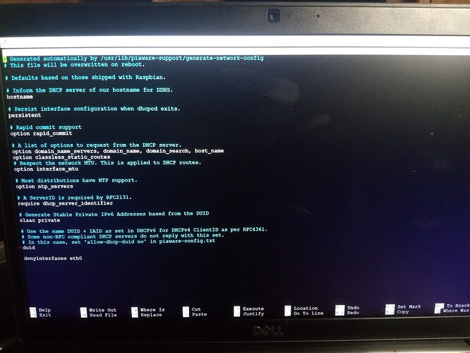

Camera photo below seems to be that of a Monitor connected to RPi. The copy-paste cannot be used in this case
I think we look at a laptop screen (there’s a built-in camera visible) and that Jay has set a fullscreen Putty session :wink::sunglasses: but I could be wrong :innocent:
