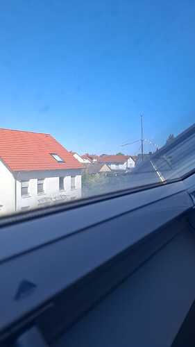

And here’s a nice photo of my crappy antenna ahahahha:
Having the antenna close to this satellite bowl can cause issues and reduced reception, at least in this direction.
If you are using the longer Ziisor antenna with 5.5dB gain should be sufficient. That’s the same value as the Jetvision antenna (also used on Flightfeeders).
