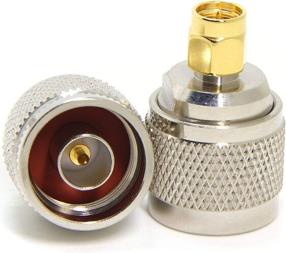

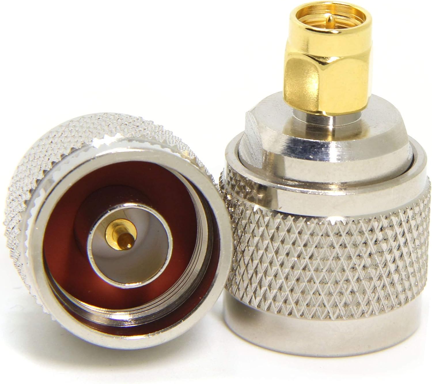

I don’t have coax, I’ve got my setup in a window atm
I use these to connect:
Heywhatsthat is a website where you can visualize your max range for a specific altitude. Has nothing to do with antenna connectors.
