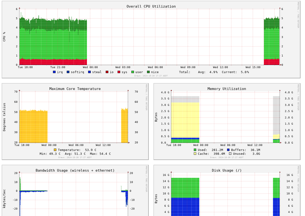

I have rpi4 Deb12 running since abt a year, no issues, just noticed now, several hours ago my graphs stopped charting, by the time I’ve noticed, it’s all OK again, anything to check/look ?

had another shorter break an hour or two ago…

What about the system logs? The issue is not with graphs1090, but with the collection of data such as from dump1090-fa or whatever process you are using.
voyteke:
probably a power outage.
graph data is saved at night, so probably a power outage at 16:00 local
oops…ahhh…
early afternoon I was updating firmware then ROM on PoE switch, which involved rebooting the switch…
as I had difficulty with ROM, switch was rebooted multiple times, RPI is powered from that switch…
(PC was ‘too far’ from switch, was not getting ROM option till PC was on the switch itself)
