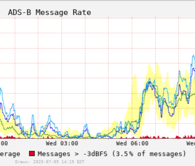

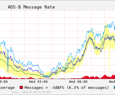

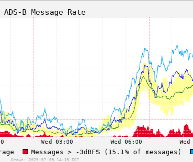

I use default gain setting adaptive on my all 4 Pis. The “Messages > -3dBFS” figure varies considerably (4.6%, 15.1% , 3.5% , 6.3%) as you can see from graphs I am posting below.
Pi-1
Pi-2
Pi-3
Pi-4
