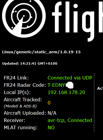

This one:
FR24 not working anymore…
And this one:

Keep everything as it is in above screenshot, just add --net --net-bi-port 30104 in field Process arguments (where you have --lat 47. --lon 9. `), Save, and Restart.
