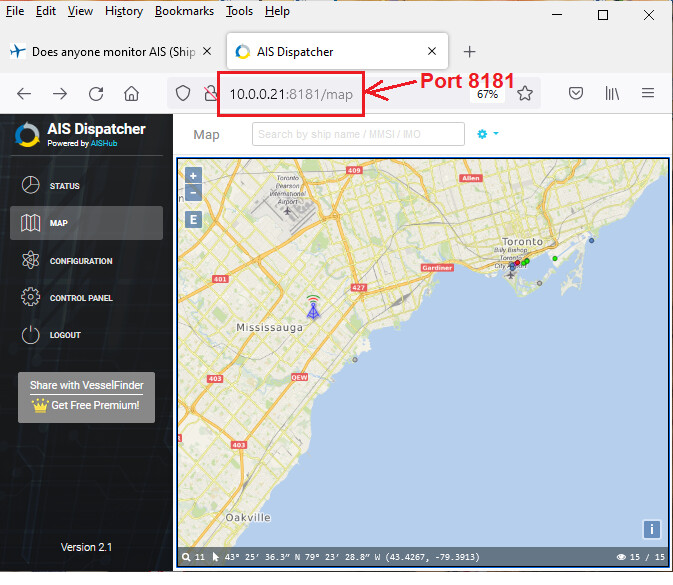

Found workaround for conflict between Dispatcher Map and Skyaware Map
Issue following command to open file aiscontrol.cfg, change port number from 8080 to something else, for example 8181, save file, and REBOOT RPi to restart AIS Despatcher with new port number for its map: IP-OF-PI:8181
sudo nano /home/ais/etc/aiscontrol.cfg
CLICK ON SCREENSHOT TO SEE LARGER SIZE
