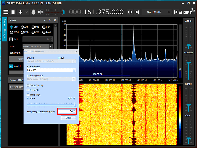

OK, found the bug.
It was a silly mistake. I have set ppm correction to -34 instead of 34.
Once I removed the minus sign, I started receiving lot of messages

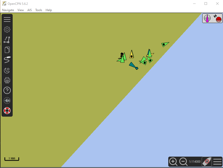

Windows Command Prompt
OpenCPN

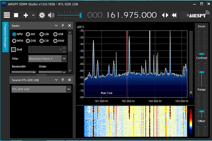

This is what I see in SDR#
The signals for both AIS channels are clearly visible. You can adjust the RF gain in real time to improve the signal to noise and make them more visible.
It is also an easy way to visualize the frequency offset once you have calibrated the receiver. (I use a local trunking radio service site I know that is GPS locked to the correct frequency to get the actual PPM)
The ships at the north end of Port Phillip Bay are about 12 km and the channel marks at the South end are about 60km away. I use a dipole mounted outside but without line of site to the water.
You should be seeing much further than me.
S.

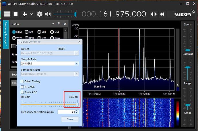

This is what I see now in SDRSharp AFTER removing -ve sign from ppm -34
You seem to have a problem.
You should see the same whatever the offset. You are looking at a segment of spectrum and the PPM setting just slides the scale along the x axis. It will of course move the signal right out of the bandpass of the FM channel you are listening to for AIS.
Can you listen to that strong signal at 162.050 and identify it?Whatever it is it seems to be related to all the traces you can see in the waterfall. Also try sliding the gain control down and see if that clears it up.
Is it still there if you disconnect the antenna?
S.

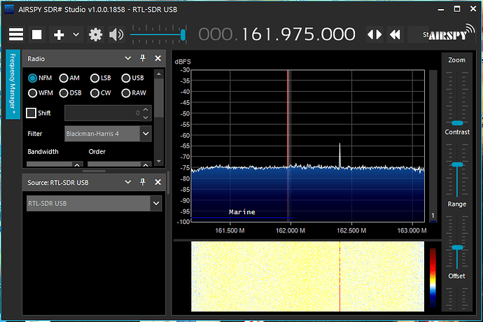

The strong signal, which is very close to 161.975 MHz is voice transmission (weather)
With Antenna Connected
With Antenna Dis-connected
