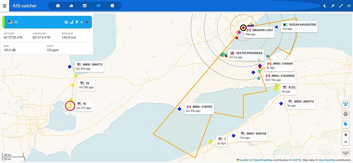

This morning I was surprised to see many messenges in the ais-catcher window, which indicated a vessel in motion, but I did not see anything on the lake. Only I after I zoomed out, I found the vessel, an Australian SAR plane.
Not sure what it was doing so far away from home, maybe it has since been sold and still sends out the signal. Unfortunately I was not quick enough to check if I got an adsb-signal as well.

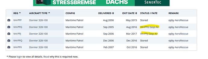

The AMSA apparently leased two aircraft to a company called EASP Air based in in the Netherlands.
One has been in use all the time, the other, VH-PPG (7C4E12), now PH-EAB (486462), was apparently almost immediately iretired in 2018 and has been recently reactivated.

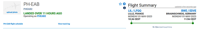

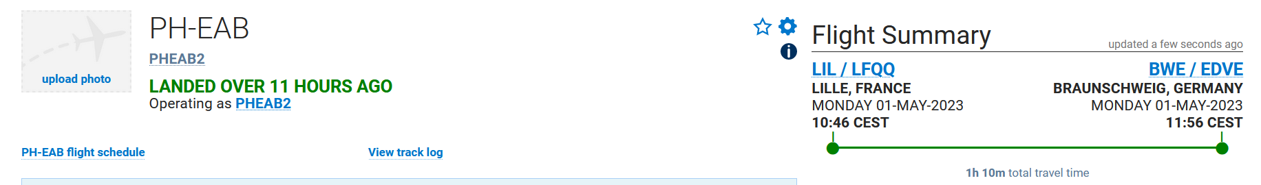

Today it was flying from Lille to Braunschweig, that is the flight where I picked up the AIS signals.
If you search for PHEAB on FA, you find the this flight, and earlier ones from Lille, the name EAGLE3 and the route looks like some patrol flight over the channel coastline, e.g. Calais.

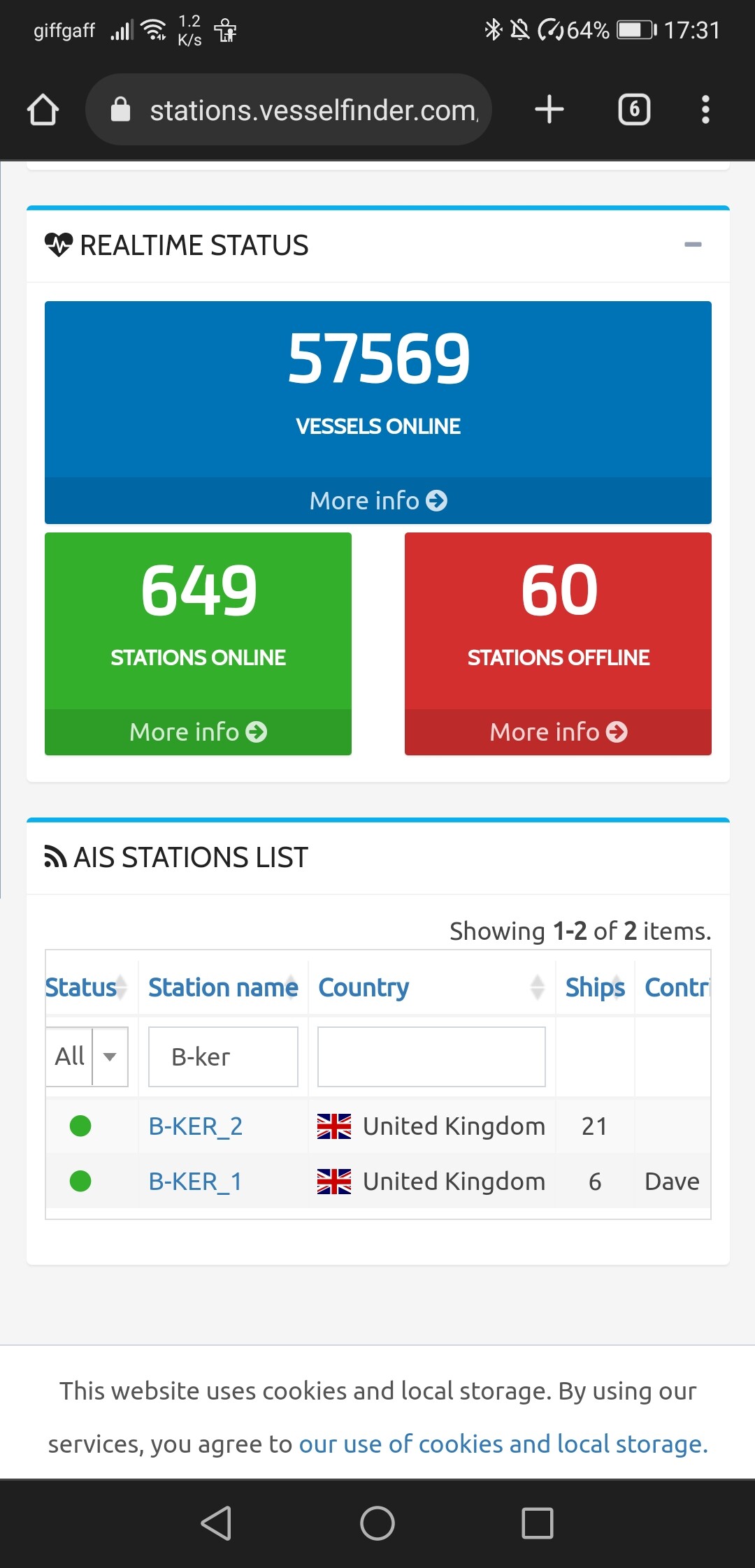

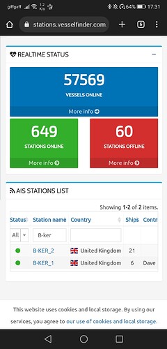

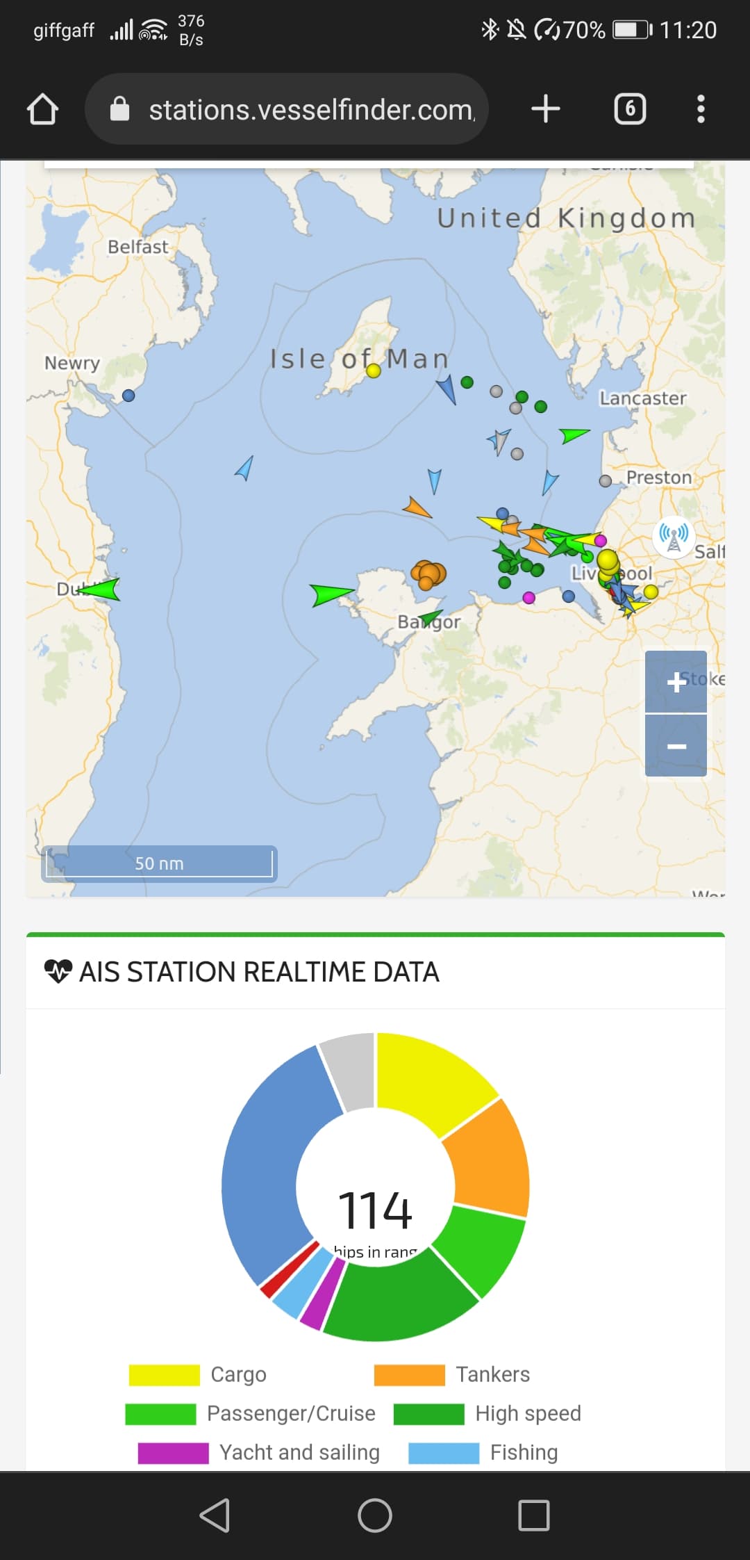

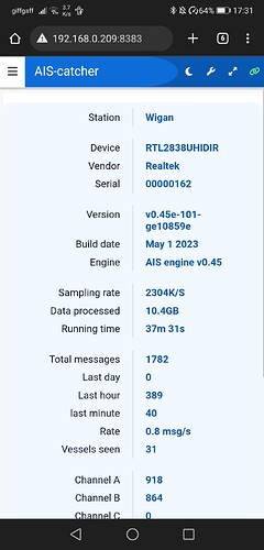

So as I had a day off from work, I decided to cobble together a DIY Yagi yesterday and go somewhere I knew I would get good reception to try it out. The place I went was 286m above sea level & 23.89miles from the shoreline, I was using the AIS dongle with gain set to 42.1
So I knew it worked based on the above and decided to run it side by side for about 30mins at home, I placed the aerial through a roof and could only get it 3ft lower than the existing DIY Flowerpot antenna. The below are the screen shots at the same time. IP. 231 is the flowerpot existing antenna & IP. 209 is the DIY YAGI
So the results at home look promising with an increase in receiving on a Yagi, so I may end up getting one of these

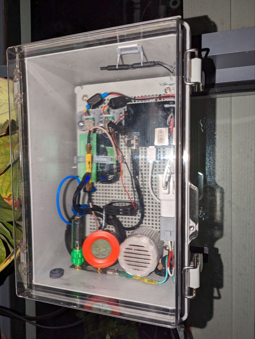

My station OrangePi Zero 2 + 860t for AIS + SAW TB0436A + DIY flower pot antenna
It is installed on the balcony of a condo (approximately 50m from ground). Therefore, it has a limited overview of the horizon.
SAW
photo_2023-02-25_21-28-19
Antenna
photo_2023-05-09_02-43-59
Box

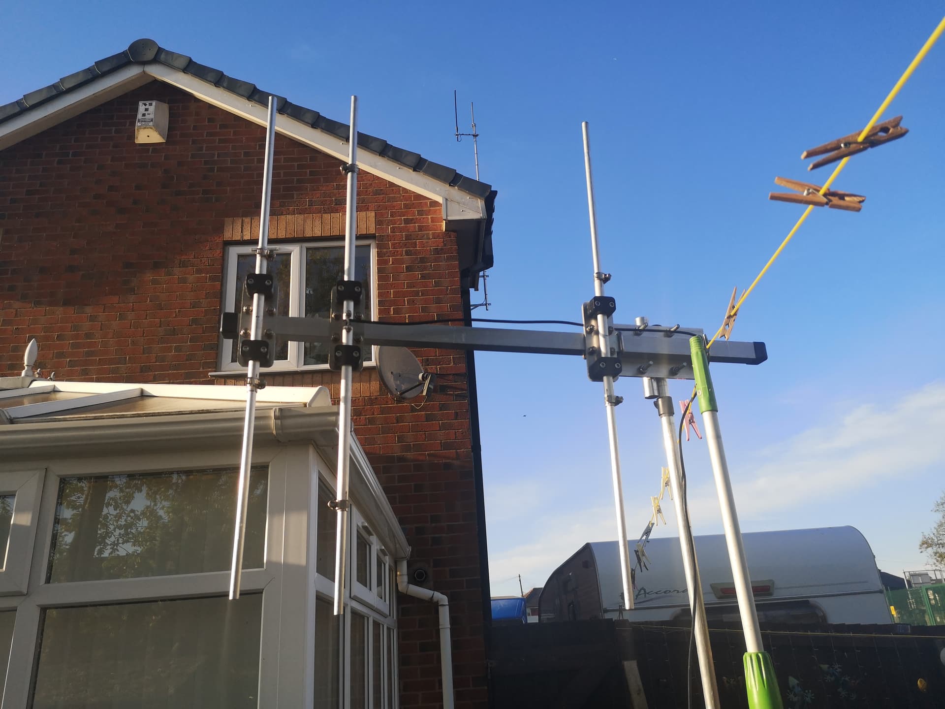

So I found a used 2m band yagi with adjustable elements local on FB Marketplace and have adjusted the elements as per an online Yagi calculator now I can’t verify if its tuned for 162mhz as I don’t own a VNA, but it is currently picking up vessels 40nm out which is the same range as the flowerpot on the roof 26 foot above ground & yagi is 12ft above ground.
