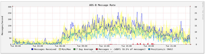

As for my quest… well its ran for a week… Consistent results, plan on removing the filter as that was installed before it was isolated to be a USB noise issue… I’m trying to change a component at a time, slow going but seem the week sample seems to give a good base to work from:

Number of tracks with single message and aircraft w/o position seem to be a bit high.
Can you show us the first chat with messages? Need to check the number of messages > 3dBFS

Strange, no traces about too many messages > -3dBFS

Your values regarding > -3dbFS should not be higher than 5%. But this is not the case for your setup. That’s what i wanted to check
It looks like he has less than 0.5% of signals greater than 3dB below full scale. So he has very few strong signals.
