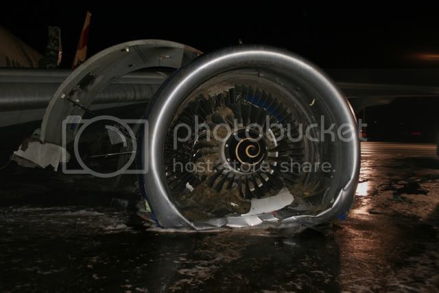

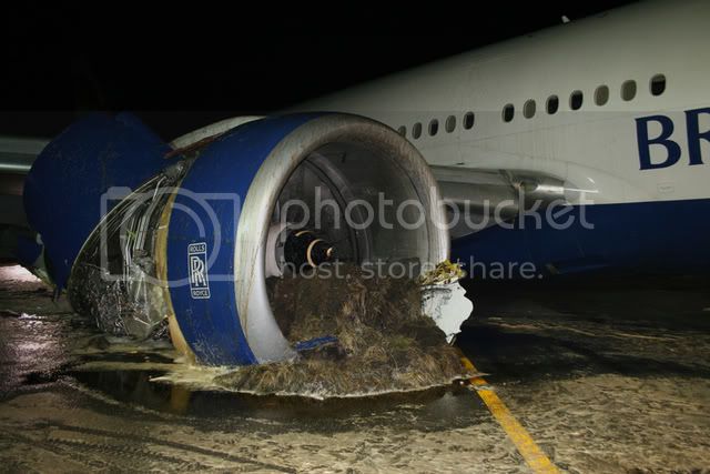

Any thoughts about the difference in dirt uptake into the engines???
#1 was turning, #2 was not?
Inadvertant thrust reverser deployment is not the cause. If you look at this picture of the right engine the reverser cascade vanes, that are partially visible due to the broken away portion of the cowling, are not fully exposed. When the reverser deploys that portion of the cowling area translates backward and exposes the entire cascade vane ring. Further, had the reversers deployed in flight at the point where the aircraft “lost power” the aircraft would’ve pitched nose down, as the engines are below and forward of the lateral axis of the aircraft, and the outcome would’ve been far more disasterous.
