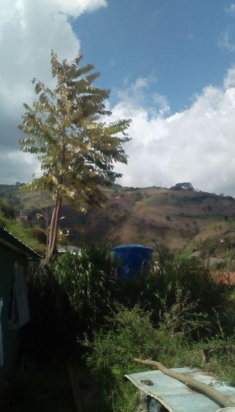

Yes. Sure, look. There is the antenna placed about 7 meters high
There are higher mountains in the distance.

Try removing the filter, you only really need it if you live with a cell phone tower close by or in a “noisy” city centre.
You can also check this post for finding out the max range at your location. Mountains close by do not help.
Do you see planes nearby that do not appear on skyview? Then check the setup, like cable, connectors, try a different antenna, there are some that are easy and cheap to make.
You cannot change frequency.

On a RPi feeder, green means that the feeder has received data recently, I assume it will be the same on a flight feeder.
Now yellow will probably mean it is not receiving any ADS-B signals. Two possibilties here, either there is nothing to see, i.e. no planes nearby, mountains blocking signals, or something is wrong with your equipment.
Looking what other people have written in a different thread, it seems the first is more likely. However, another feeder nearby seems to receive around 100 planes per day, or something like that IIRC.
Thank you very much friend for answering, if I think it is for the mountains that cover and that also the plans with transponder are few that pass. On the other hand, if airplanes pass the radio signal if it turns green.
