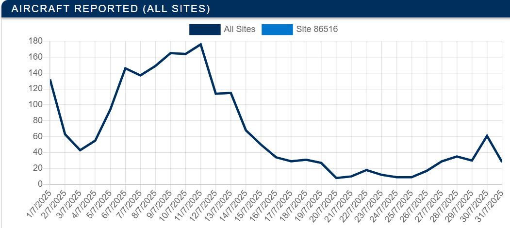

I have the 1090MHz Flightaware antenna with GPS, but lately it has been failing. I get better reception using my 144MHz vertical as a comparison.
The GPS have not worked for some time either.
I have measured the cable and it is in good shape. The connector on the antenna is corrosion free due to my own sealant.
Today I tried to twist off the fibreglass from the base of the antenna with a pipe wrench, but it would not move and all it did was to scratch it.
What I suspect is corrosion on both antennas inside the fibre glass tube.
Normally I have received 180-200 planes a day for years and regularly some beyond 400nm, but now the antenna has failed.
Is there a better antenna with a sealed circuit inside. The design with an open amplifier and electronic components is just too prone to humidity.

Hi thanks for the reply and information. The equipment is all from Flightaware. Software is version 10.0. I received it in August 2018, and I got a new antenna from them in 2022? after the outdoor connector was corroded. The software is all remotely updated, I do not touch that unit myself unless it is to check for status.
I made sure to seal the new connector in plasti-dip and also the joint between the fibreglass and the metal part on the antenna itself. The most likely cause for corrosion is condensation I think.
I see a clear improvement on number of receptions and range when i change from the 1090MHz antenna to my off band amateur radio one, so this is clearly not software related, but range/sensitivity due to bad contact inside the antenna itself.

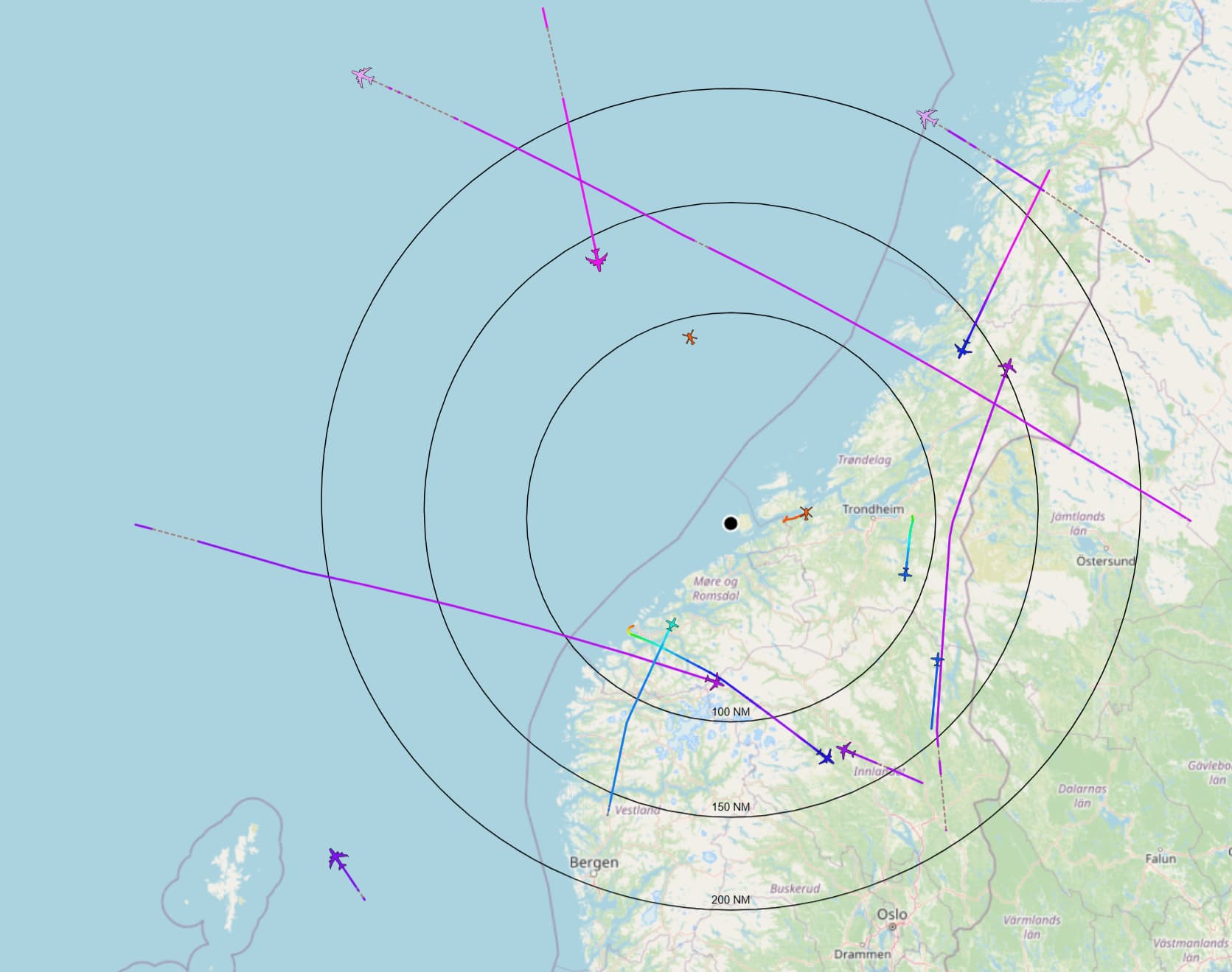

I have bought a new 9dBi antenna and external preamp with filter from Aliexpress.
I use an RG6 (75 Ohm) gelfilled cable. The impedance does not matter that much because of the preamp. Anyway the signals are better than with the FA supplied antenna when it was new.
Signals along the horizon seems to reach further beyond 200NM and the ones overhead still are received well despite the flatter diagram.
