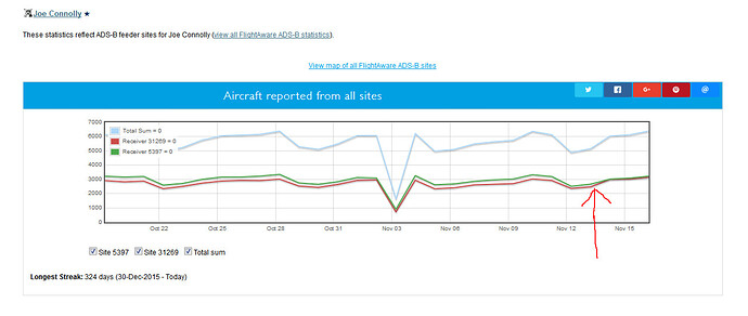

So, I’m running two separate but similar setups on my roof and I installed the PSP on the lower-performing one. I saw an increase in the total number of aircraft tracked per day of about 100. I’m thinking it’s probably because i’m regaining that couple db loss by removing the inline filter. Picture shows where I installed the new PSP.
