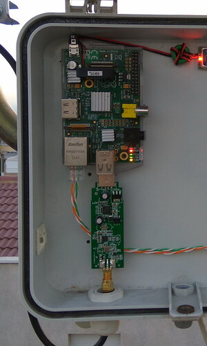

Active ventilation does not have to be harmful.
In my case, I live in a very hot area, these days we are with an average of 40ºc with peaks of up to 48ºc.
I have the PI and the dongle (PSP) inside a box on the outside, I had temperature problems, even blocking the dondgle.
I solved the problem as follows …
Remove the PI from its box, remove the dongle from its box, add a fan.
I checked the noise figure before and after placing the fan and I have not noticed difference.
The system is now fairly stable.
