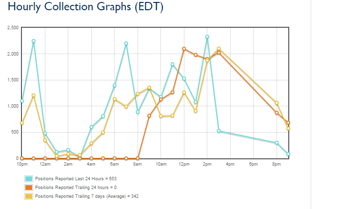

Something just isn’t right…looks like something keeps happening at 3PM and then it doesn’t reconnect until 8PM.
