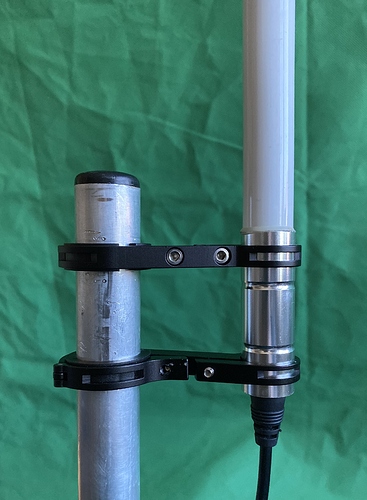

It’s been a while, but I’ve found some ace clamps!
Something like This:

Very good idea. Suggest checking your local dollar store. Mine has a good assortment of bicycle accessories. One never knows.
Looks fantastic but unfortunately about four mm to small to fit the Jetvision aerial. That’s a real shame as otherwise it would be perfect for fitting mine to the smaller pole I’m using at the top of the hexbeam.
That might be useful if the mast/aerial diameters are the same!
In my case the aerial base is 22mm and the mast 25mm.
You can get those hydraulic pipe clamps as singles to… Premium Manufacturer of Hydraulic Port-to-Port Solutions | STAUFF
I use mast extension clamps. About $US10 the pair in Australia.
Each mast can be from about 15mm to 50mm
or these in the UK
S.
edited for a better image
Stauff clamps are really good - I’d need to get the 38mm version and pad both sides out. That’s a real possibility though.
The problem with a lot of these is that the threads don’t go far enough and so you can’t use them with small poles.
