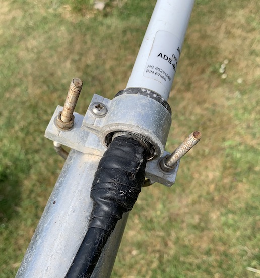

I’ve had mine down over the weekend and this is how it looks.
You can see where I taped it up as far as I could get. I’m less than impressed by the quality of the u-bolt with rust forming already.
That is my concerns as well. But i will see how it look like in some months. For me it’s easier because the antenna is on my balcony.

That was put up outside on the 24th November so it’s only been six months.

You do know that a crimp connector isn’t waterproof?

How could this possibly be waterproof?
No gasket, no seals.
This is a waterproof N-Trpe
