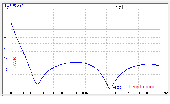

OK, I will try a 206 mm straight whip.
Meanwhile given below are simulation results for such a whip
Straight Whip With ground Plane
Length = 20.6 cm (206 mm)
Gain = - 3.89 dB (minus 3.89 dB)   :x:
SWR = 1.085   :white_check_mark:
Radiation Pattern = Undesirable shape   :x:
Monopole Length vs Gain
Monopole Length vs SWR
