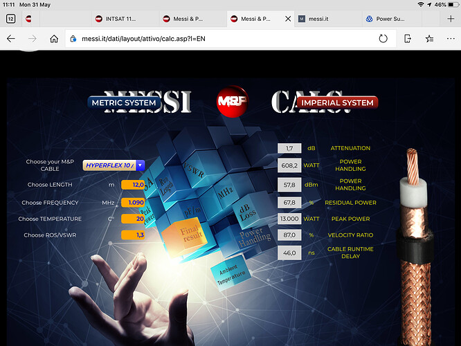

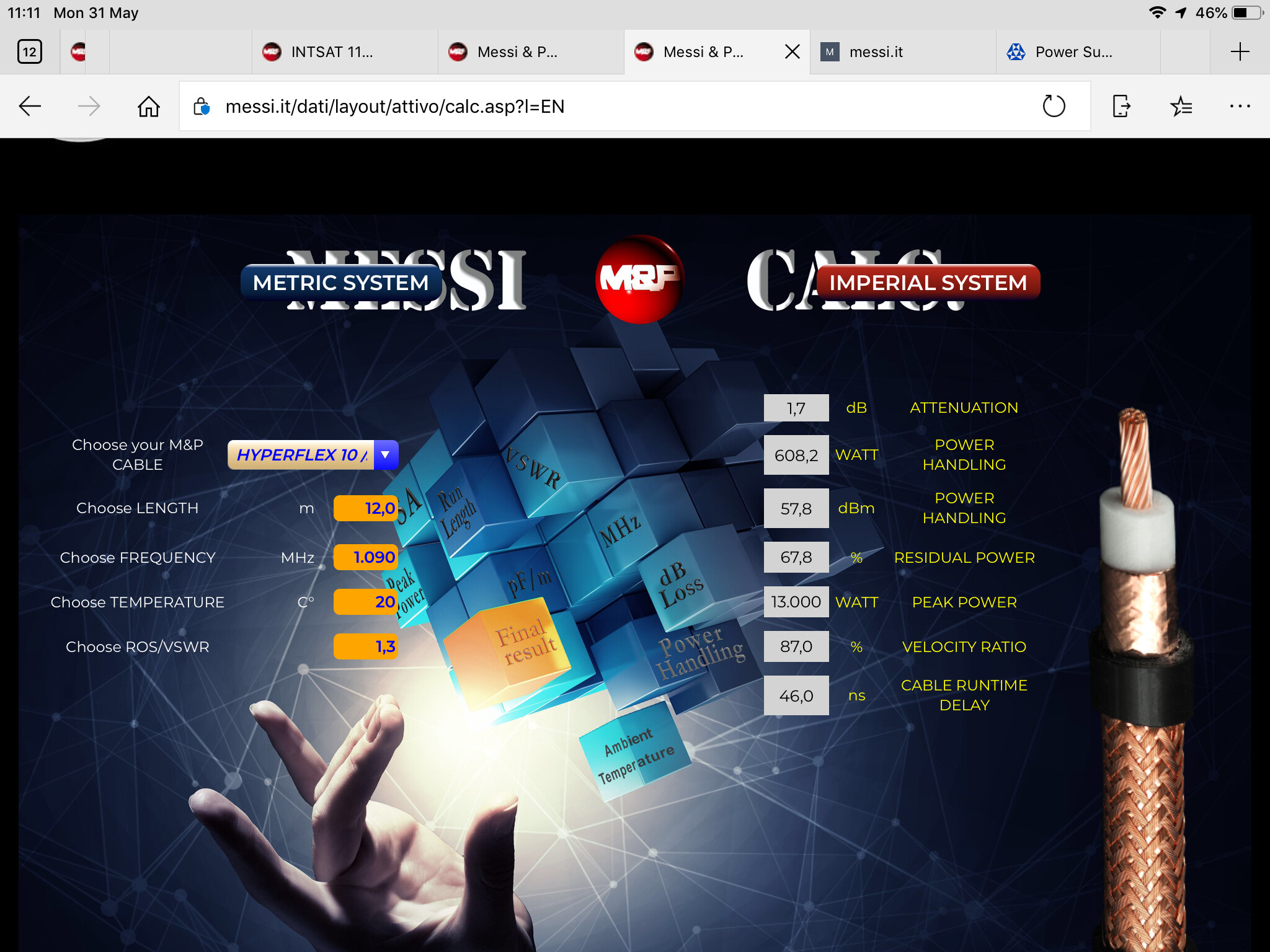

Hi alleyoopie maybe this help…
or this …

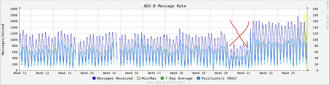

Almost 5 years ago I bought a FlightAware ADSB antenna. Two years ago I mounted it outside on a pole.
A few weeks ago I got a problem with it (see the red cross in the graphs).
I ordered a Vinnant COL1090/5-H F as a replacement. Not very expensive, solid build and leightweight.
Left side from the red cross is FA antenna and right side is Vinnant one. I only changed the antenna. Problem with the FA antenna was water inside the N connector.
Maybe it could be helpful for others who don’t want to spend a lot of money.
