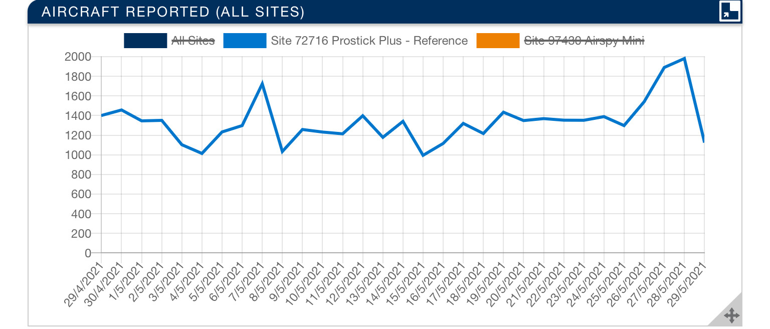

Not wishing to be a party pooper but don’t underestimate the effect of the better weather in the UK over last couple of days though.
Lots of light aircraft taking advantage. I’m on the south coast and my numbers have increased a lot over the last couple of days with no changes to my setup.

Same here, especially today. Most of them are visible via MLAT only.
On a normal day i have a 80-20 ratio, today it is almost 80-50 (ADS-B vs. MLAT)
Just be aware that conditions are very good today, the best I’ve seen for some months so you might also be benefitting from that a little bit.

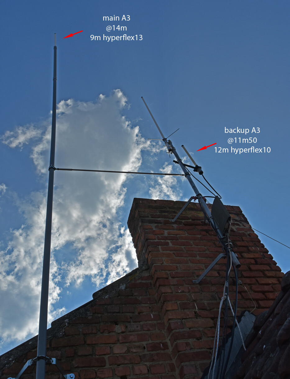

I’m still trying to figure out why my backup Jetvision A3 is outperforming my main A3 antenna.
We’re not talking about a few percent but 17% more messages reported, 15% more A/C reported and my backup feeder can track over a longer distance…
Different cable? Connectivity issues? Different settings?
You offended the main antenna at some point, so she hates you now.
You’ve swapped the setups connected to them, as in swapped the coax coming from each antenna to the other system each?
I already swapped the setups (cavity filter, rtl-sdr lna, airspy mini, Pi4) and that reverses the results, both feeders are identical with same Airspy settings including gain level. One thing I haven’t done is swapping the cables, it takes a lot of time and it’s quite dangerous with my shaky knees on top of the roof only holding a metal pole! :nauseated_face:
Are you sure about which is which?
And what’s that 3rd antenna?
I’d expect to clearly see the other antenna in pTracks on the backup antenna creating a dead direction.
If you look at the pTracks for both, do you see that?
There’s no confusion because the coaxial cables have different sizes (10 & 13mm) and both Pi’s have unique DNS names like pi1.lan & pi2.lan to avoid mix-ups.
The third antenna is a 2m/70cm ground plane.
Both A3’s are about 2m apart so the ‘dead direction’ is less than half of a degree wide, this will be barely perceptible due to the mitigating effects of polarisation skew, atmospheric refraction and the very short obscuration interval.
