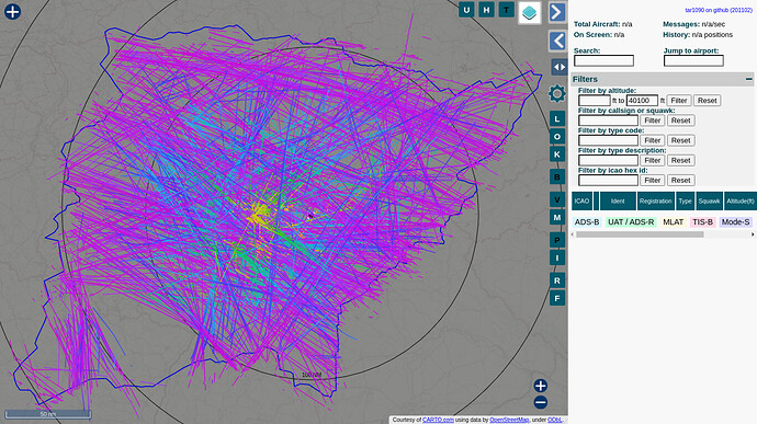

Well the better your horizon the more your receiving setup will also be important to get more range.
So if you’re already completely limited by terrain a better antenna / coax / filter / LNA / SDR combination will often add very little.
On the other hand if your terrain limit is basically a flat horizon the signal chain mentioned above will often be the limiting factor.
Then with reasonably good gear and a flat horizon you’re mostly limited by the curvature of the earth. (always plays a role obviously :slight_smile: )
/tar1090/?pTracks with rings at 100,150,200 nmi:
As you can see i only get the max range in a very small portion of the sky.
I should make something similar to pTracks that excludes MLAT, you often get MLAT results / positions from FA a couple of minutes after you last received that aircraft.

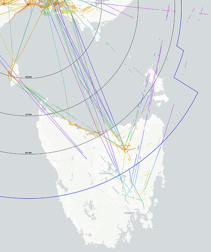

I’ve done just that - not an oak but a tea-tree (Melaleuca Alternifolia). The combination of moving the setup about 40m uphill and into the tree gave me an extra 8 metres in height amsl and an unobstructed view out to sea to the south. This significantly improved the range at which I first pickup the few aircraft in that direction.
I think another factor affecting range that’s worth mentioning is atmospherics. I’ve only had the antenna relocated for a week, but the maximum range seen in the last 24 hours has been exceptional relative to previous six days:
No changes to my setup (or the number of distant aircraft as far as I can tell). The thing that has surprised me has been the altitudes of some of the most distant aircraft:
The southern-most track starts at 10775 feet, around 300 NM from my location.
(Note that the 40,000ft heywhatsthatcom-range-outline is from my old location, but I don’t think it will change much.)

Nice picture of Tasmania. I’m also in Victoria and get the top of Tassie, but that’s my max.

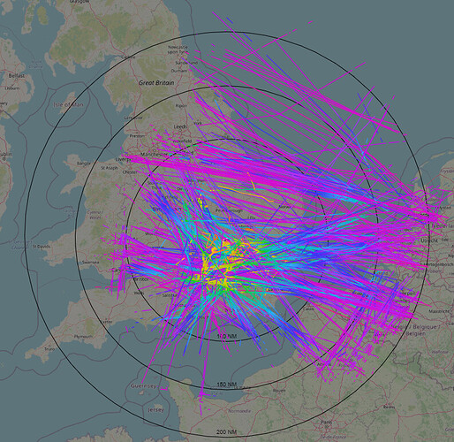

Max range sits around 230nm pretty much all the time. It’s pretty flat where I live and my antenna is on a short mast on the roof of my 2 story house.
