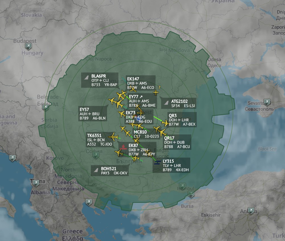

I can only guess that water got in near the cable SMA connector inside the covering sleeve and increased the impedance/resistance to very high because comparing the RSSI of planes now, i can see a +10-12 dB drop on planes that are near me, when before i’ve seen -4 dB, -4.5 on these planes, now i see -14, -15 maybe higher
here is the current situation
here is how it used to be (green plot was max range)
