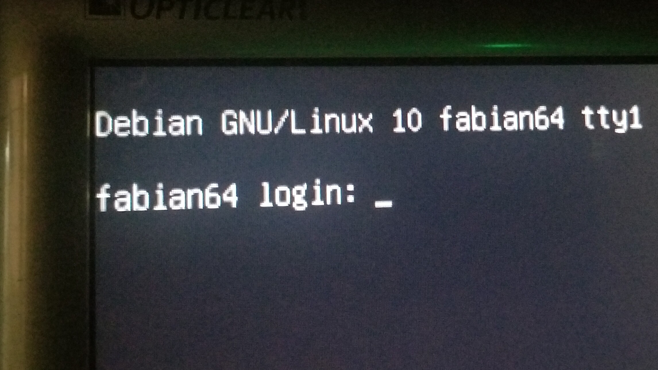

What is username & password for fabian64?
root:1090 and pi:1090; see release notes.

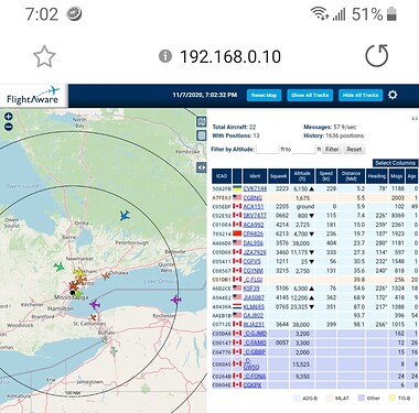

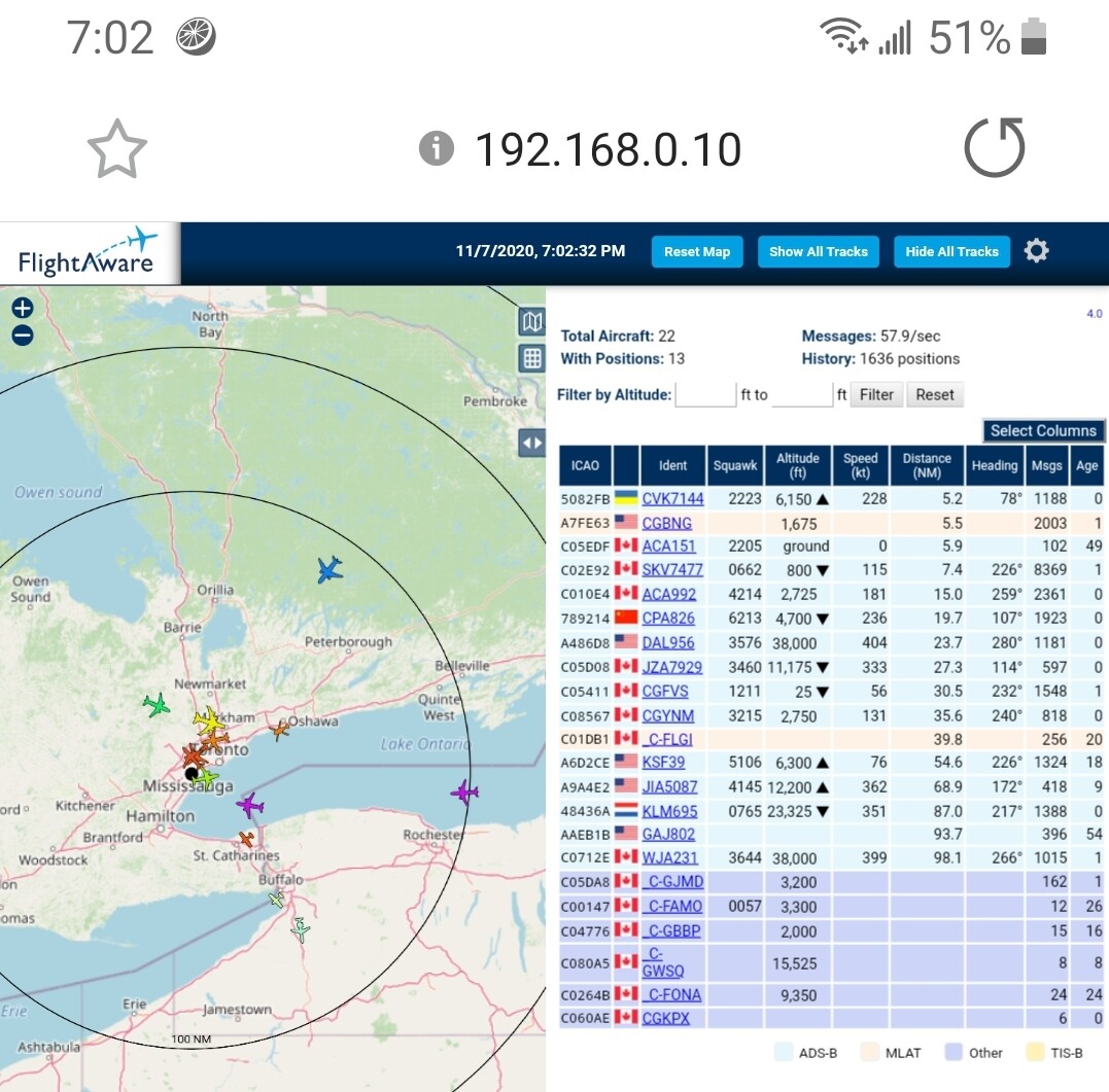

1- All times below in UTC (on map in local EDT, as it is from my phone)
2 - Perpetual responce:
sudo: unable to resolve host fabian64: Name or service not known
Working OK
