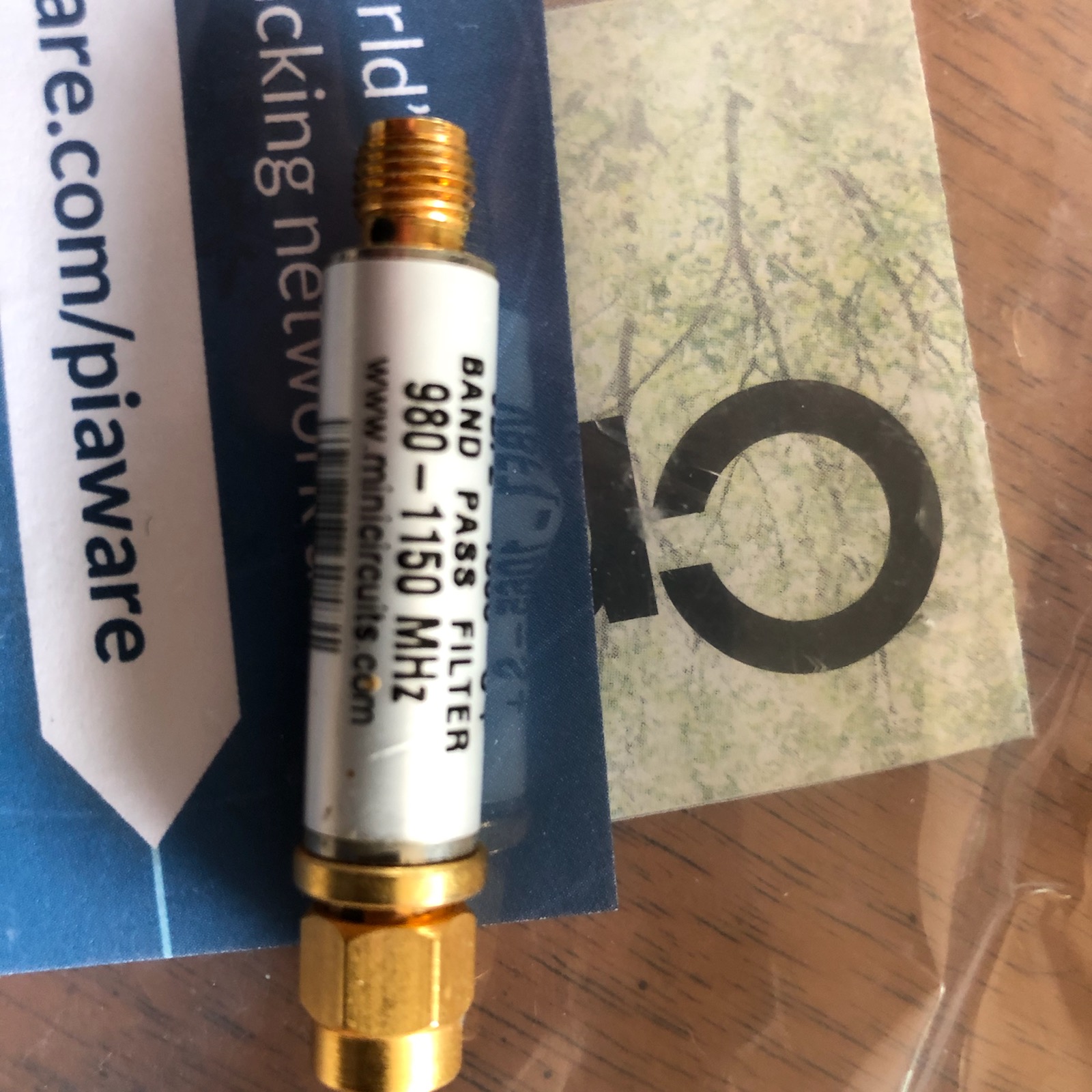

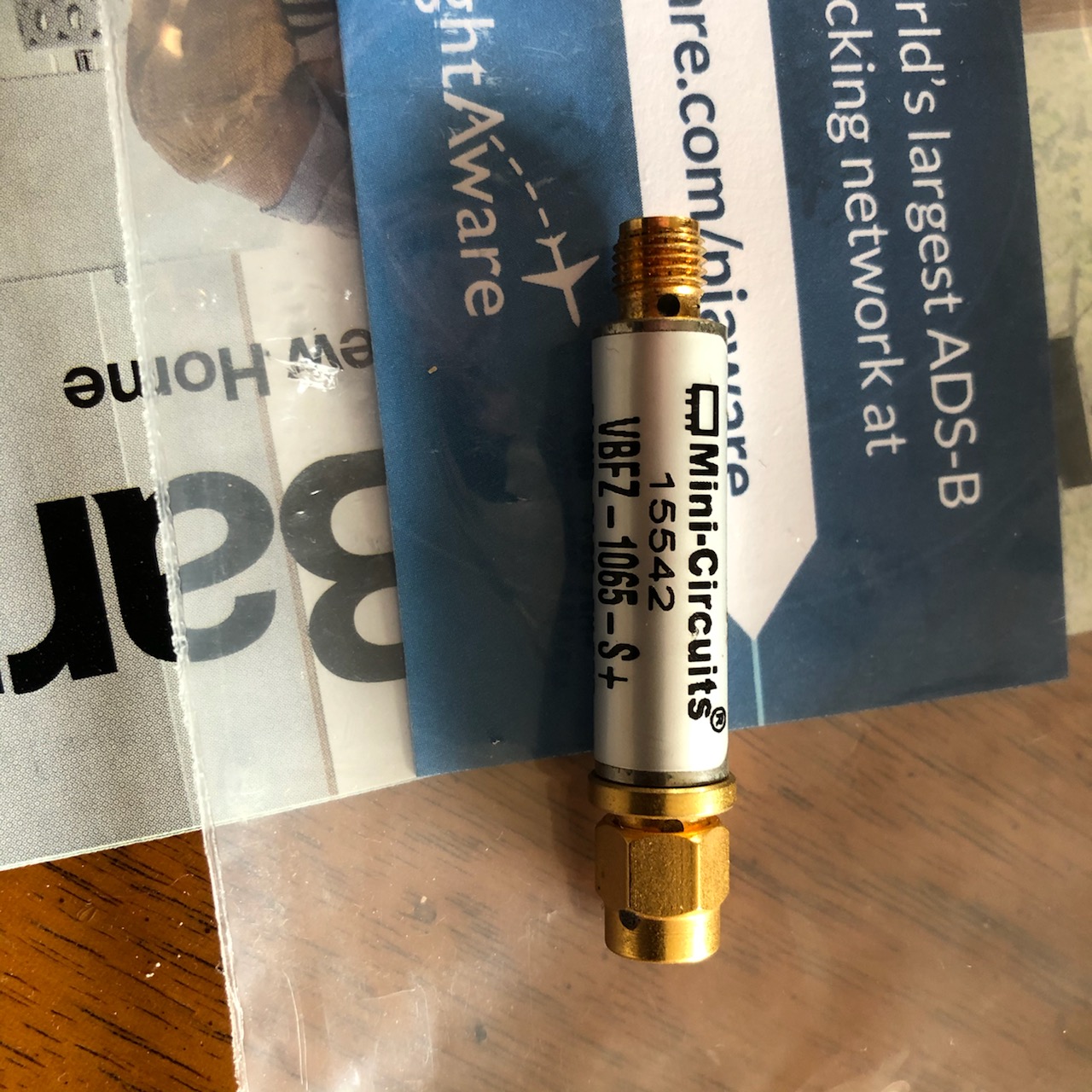

I’ve installed a “Mini Circuits,15542 VBZ-1065-S+, 980-1050 MHz” Filter onto the Blue FA Dongle.
Let’s see if a filter improves things.
Nice thing.
Looks like a hot washed FA filter tube :slight_smile:
You might need to adjust gain, depends how much you will loose due to that filter.
