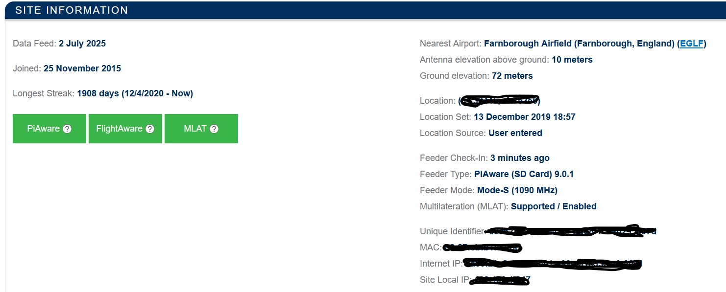

I’ve given my brother a new SD card with the latest software. He can’t see any planes on his local map. The stats page shows 3 green lights and the pi has checked in within the last 2 minutes. The hourly reports page between 12:00 and 20:00 is when the old SD card was put in the pi
Any clues as to what the problem is?

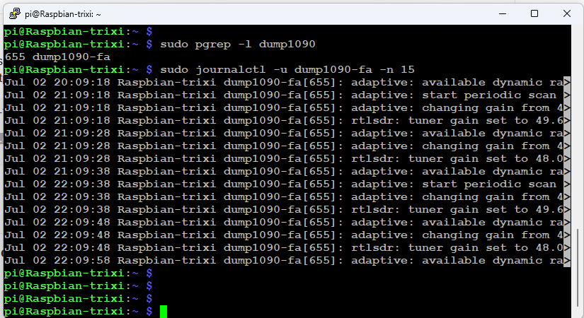

Please post outpput of following commands
sudo pgrep -l dump1090
sudo journalctl -u dump1090-fa -n 15
This is what I get in a normal system

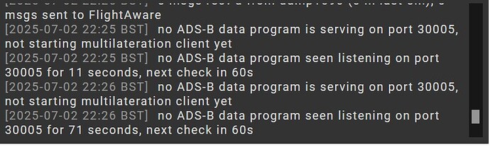

Looks like dump1090-fa isn’t running. This serves the data on port 30005 which piaware is missing based on your first screen.

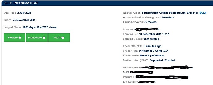

One thing that had me confused was that I had 3 green lights and the stats page said I was connected to the Flightaware servers.
The 3 green lights on stats page show status of “piaware data feeder”, and not that of dump1090-fa. Also the connection to FA servers is established by “piaware data feeder”, and not by dump1090-fa. As the “piaware data feeder” was working OK, these indications on stats page were showing OK.
