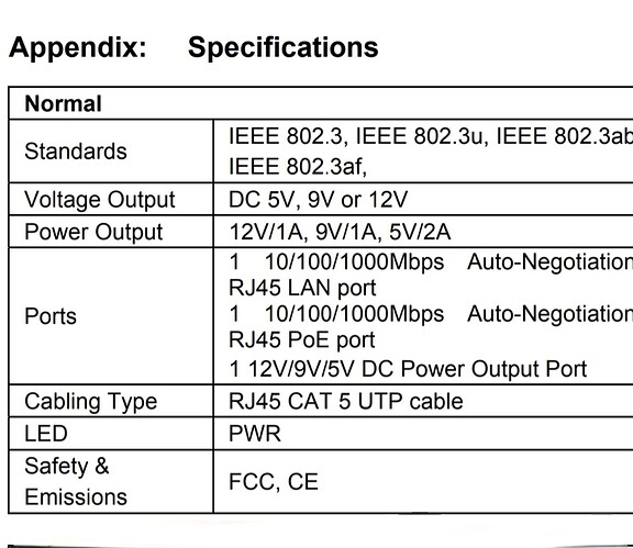

The splitter is only (?) putting out 2.4A per the nameplate. Final destination of the box/pole should be only 25 ft of Cat 6 outdoor rated cable.
As per PoE Splitter TL-POE10R Guide/Specs : Power Output is 2A at 5V.
I ordered a splitter that will seemingly deliver 5V at 4A. It’s “rated” for RPi 4. I just looked at my semi-official CanaKit RPi 4 supply - it’s 3.5A and running the 8gb Pi4 & dongle fine.
