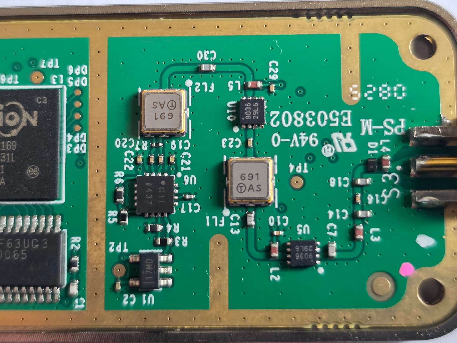

Saw this new Plane Finder dongle announced. Was very intrigued by the “Not an SDR device” in bold in the listing details… (New) Plane Finder Radar Stick
So bought one to look inside, and thought plenty of people here would be interested to see inside as well…
Not sure I would agree with “not an SDR” - I guess what they meant is “not an RTL2832U”…but in any case it’s a nice device:
  • dual LNA (Qorvo TQP3M9036)
  • dual filter (Tai-Saw TA0691A)
  • high res ADC (TI ADC10065)
  • FPGA (Efinix Trion T20F169)
  • microcontroller (Raspberry Pi RP2040 RP2-B2)
  • UART to USB (FTDI 2232)
Cheaper than a Mode-S Beast and more than an Airspy Mini which, at first glance, are likely in the same ballpark performance wise. So even though the price is high, it’s not absurdly so.
Now to check performance. Will be interesting to see how it stacks up against an Airspy and Mode-S Beast.
Let me know if you want more pictures or want me to test anything on it and I’ll do my best (can only seem to post one picture but will upload more to GDrive or somewhere else)

More pictures:

I assume that the Efinix Trion T20F169 FPGA is the hardware decoder…
That’s a very typical task for an FPGA.

The ADC used in this dongle is 10 bit and 65 Msample/s. That’s a better hardware dynamic range than an rtl dongle but not as high as an airspy which is 12 bit. It does have far more bandwidth than needed for mode-s decoding and that extra bandwidth can be traded dynamic range by using decimation.
10 bit dynamic range is about 60dB, and if they use 16x decimation that’s equivalent to an increase in dynamic range of 12dB. That improves the overall effective dynamic range to 72dB which is about the same as a 12 bit ADC which makes it similar to an airspy. Of course if the airspy decoder uses decimation internally as well (I have no idea if it does) then that puts it ahead again.
Given that this is RF signal processing we are talking about there’s probably all sorts of nuance to this which means it’s not a direct comparison. It should comfortably outperform an RTL dongle though, especially where strong signals are present.
FPGA processing does allow much better timestamping of decoded packets, but you have to also consider the other advantages. This is pretty much a self contained device. It does all the processing on board, from reception to decoding, and then passes the output over USB.

I suspect the RF path is closely tied to 1090MHz, which would limit how far you could repurpose it even given a new FPGA bitstream.
Any ideas what U6 is? I assume some kind of tuner / mixer / downconverter.
