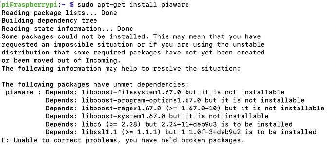

I am currently running piaware 3.7.1 and tried upgrading to 3.8.1 via ssh.
Ran update lines and I am getting this message. Not sure what is happening. Can you guys be able to help?

Did not work. I even tried running upgrade from FA website
Please provide the commands and error messages. ā€œDid not workā€ is not helpful.

You are attempting to install the Buster version on a Stretch install. This will not work. You probably installed the wrong repository package.
