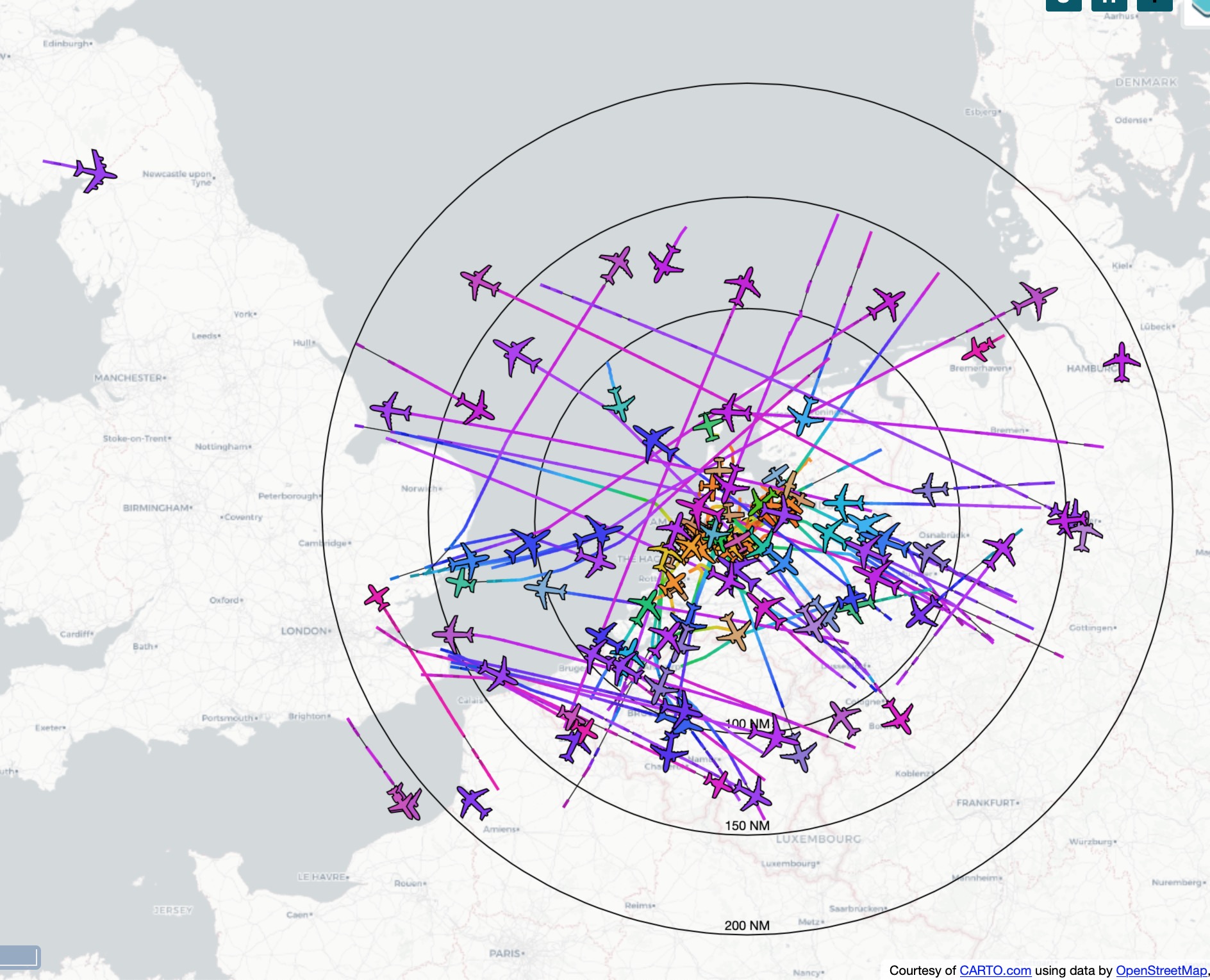

The weather must play a role… This morning at around 5 I had 3 ground stations on my map. They’re gone now, but I can always see them on planefinder with same ICAO, so they are true transmitters. One of them, the nearest, some times pops up and disappears again. Never seen the two others.
I didn’t see planes further away then I’m used to though.

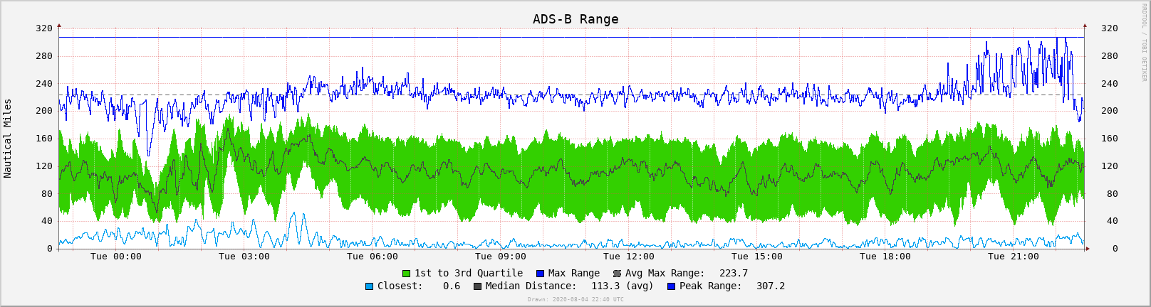

Conditions definitely up for me too :slight_smile:
Tropo07Aug20
I’m seeing aircraft up in Northern Ireland & Scotland at around 26,000 ft
The lift is extending right up from Band Two (FM) as my local radio stations are fading out in place of DX
416 nmi or about 770km is the furthest signal received since I started using graphs1090 about a year ago

Looks like i got the same today with 360NM
I would more assume a bad signal
I just checked for new ‘range spikes’ on Virtual Radar and this one popped up.
It seems to be the same flight above Greta Green (Scottish border) that Bram Jacobse picked up.

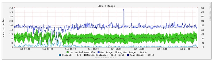

@ Keithma: great max range graph, never seen something like that with a genuine virtual wall at 360nmi, hide it or the Flat Earth Society will use it to prove their point :smiley:

Now my range plot on VRS looks like this, giving me that spike:
EDIT: Checked my yesterdays report on VRS and I can confirm that it was the same aircraft.
